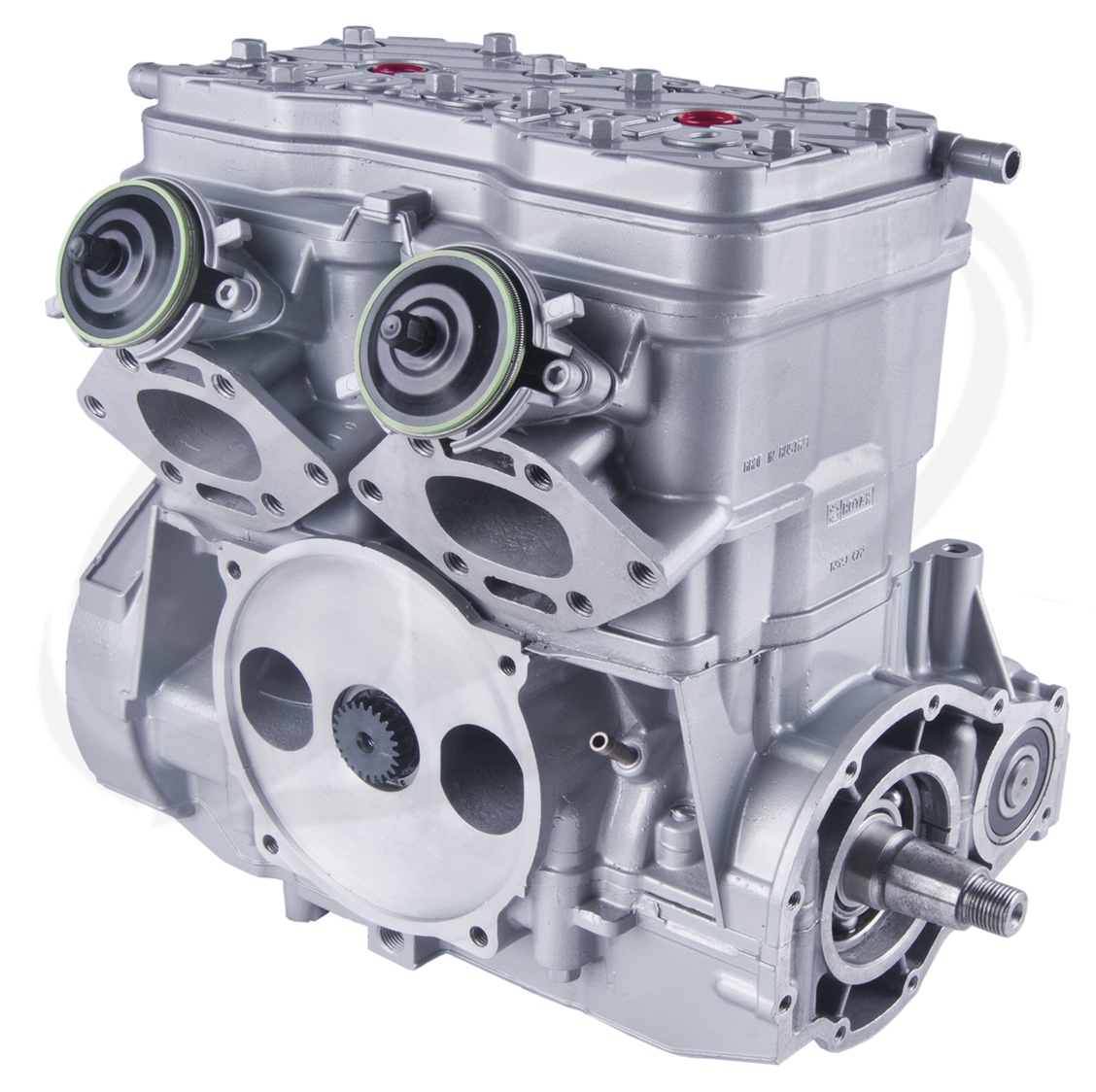

#14
Yes, that is a RFI fuel injected ski.
THe Tempo line in your picture is just a water line for the exhaust system, not a fuel line.
THe bigger question is what happened to the front of your cylinder? It looks like it is covered in bondo and spray painted over.

#15
Yeah kinda weird. I went out and scraped some off and it looks fi e under it. Not sure what that's about...

#16
I would keep an eye on it.
If I had to guess the cylinder cracked from freezing with water in it and someone tried to cover it up with a crappy J B Weld patch. They never came from the factory looking like that.

#18
Looking at the picture again it looks like they even dribbled it on the rubber mat under the fuel rail.

#19
I wish I had a clear view of another one to compare it to. I don't really know what I am looking at and the pictures I am taking aren't really helpful.

#23
My only thought is the last thing I want to do is get out on the water and have it become a problem. I wouldn't take all the material away, just enough to see if there is a valid reason.
There seems to be a few "redneck" things about this boat that the PO's did. If I do a little grinding and find that there is in fact an issue I will try to repair it better.

#24
Well the proper repair will be to pull the engine and replace that cylinder with a good one. That means at minimum a complete topend rebuild.
If it runs and doesn't leak I'd just leave it as is for now, but be prepared to replace in the future.
