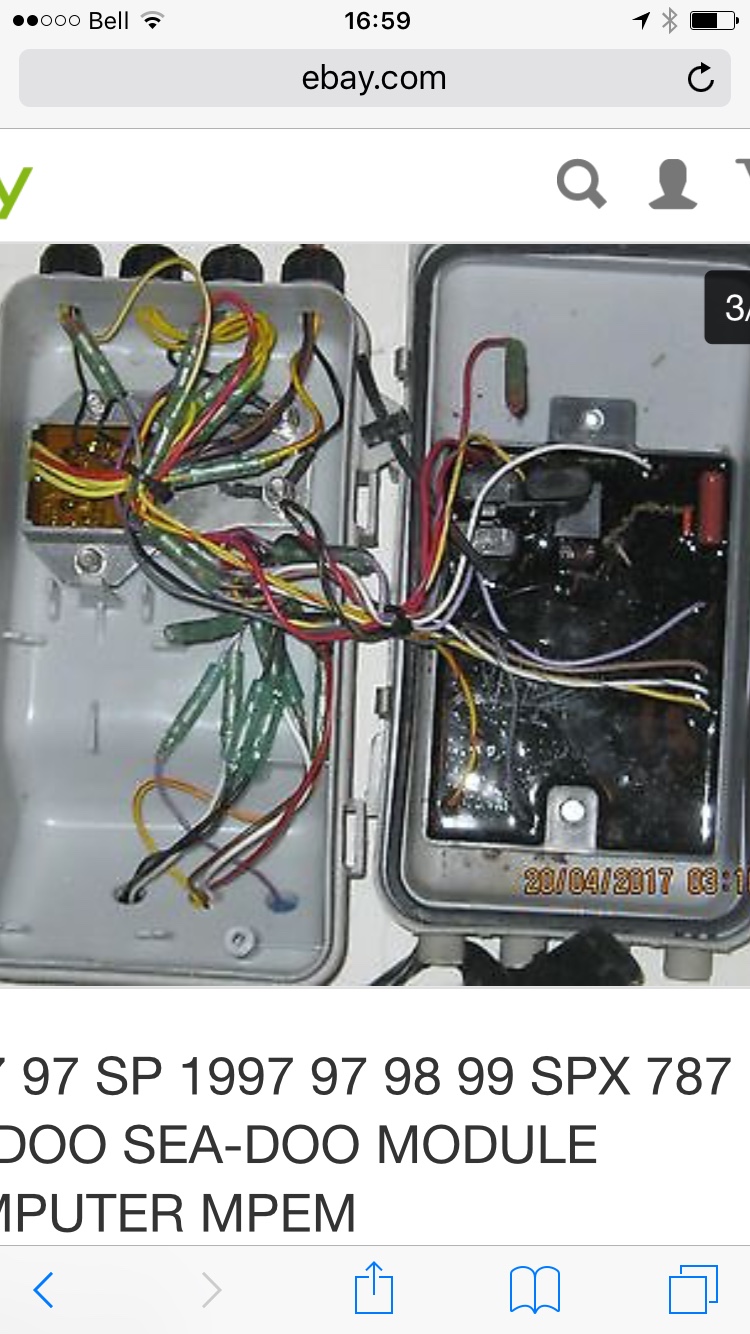

You can do it, but you need the entire front electrical box. And maybe the harness from the front box to the motor plugin. I actually did that once. I pulled the harness and box out of my 96 gtx and put it in the 96 gsx (late year 96 that has a 97 mpem). It fired right up and proved my MPEM was bad. Mine had spark, but it would crank and crank and crank then fire with a HUGE backfire. But then sometimes it would start and run for a few seconds and die. As an FYI, minnetonka4me usually has them. But they are kind of pricy. But he will take it back if it does not fix your problem, with a restocking fee. No one else will do that.
