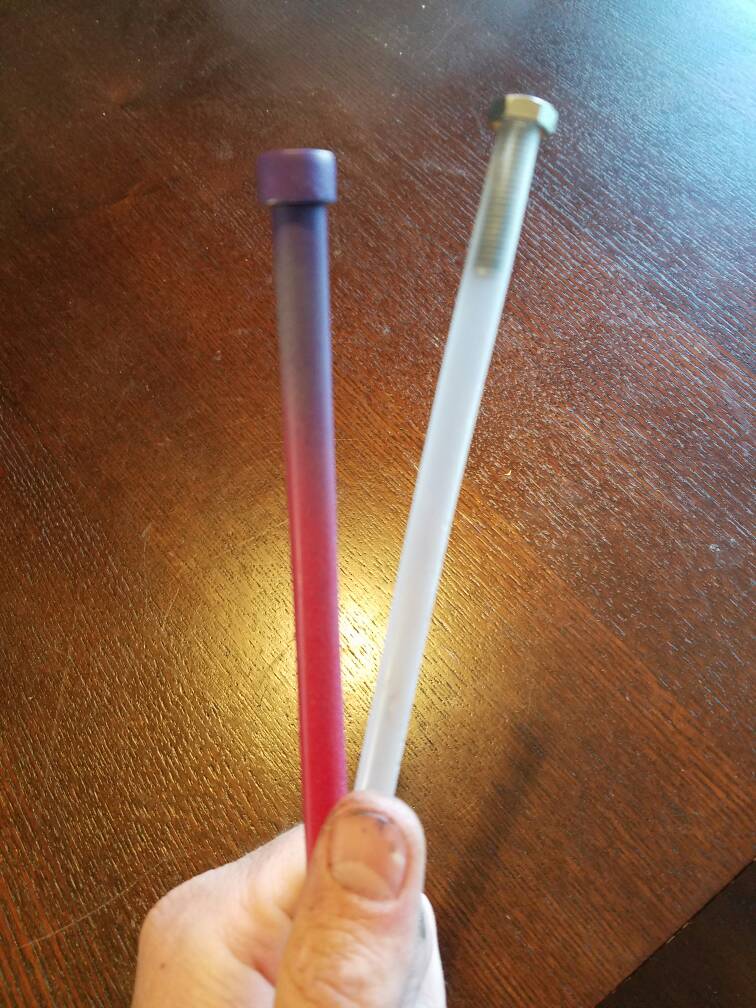

Where did you get the purple paint?I keep running into more and more parts to paint. Painted mag cover bolts and rotary cover bolts along with raves.
I did find one way to make painting the bolts easier, assuming you aren't painting after assembly. Since my RV cover is polished aluminum I could not paint after assembly.
I found that regular drinking straws work perfectly for most bolts and the wife had some larger "wine" straws for the RV cover bolts. Much quicker that taping off threads and let's you hold them away from yourself while painting. I just stuck the other ends in a potted plant to dry.
I'm sure the reg hex bolts will need a touch up after being torqued.
