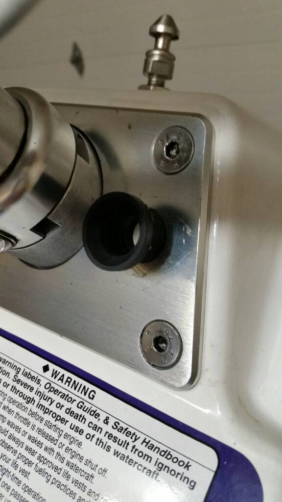

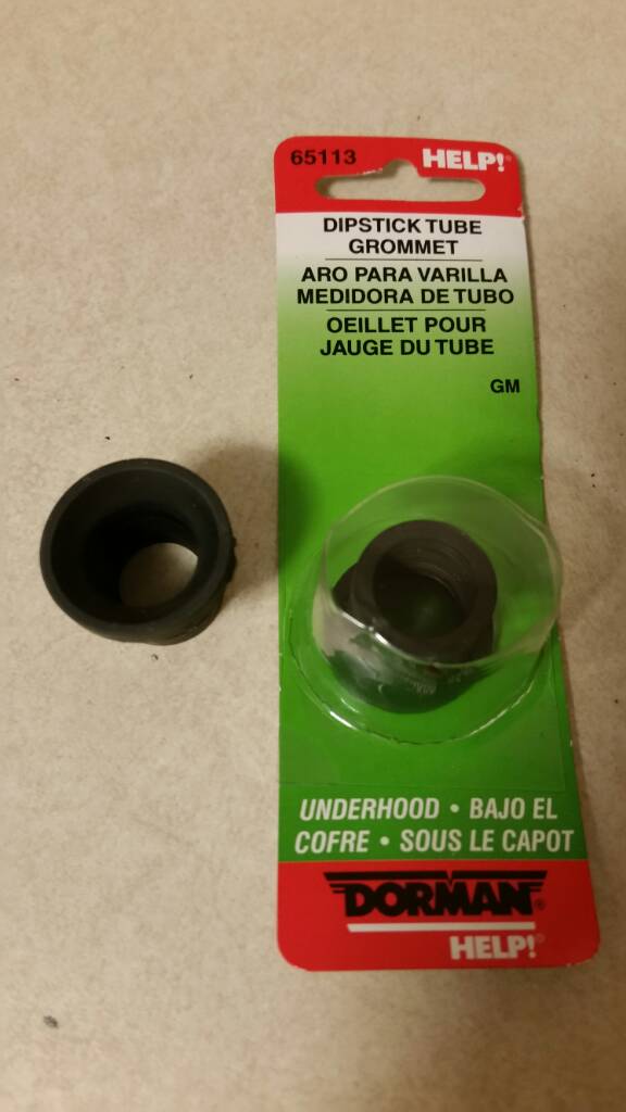

Probably not a bad idea in your situation.I finally solved my quest to find the perfect UMI cable/wire protector grommet. I couldn't find anywhere online indicating what to use as a replacement I could only find ppl saying it's not really needed. Well I wasn't risking wires chafing on an expensive EGT gauge (5 sets of wires alone) + start/stop, throttle, etc on a $3 grommet.
So after hours of looking at stores and online here is the pretty much perfect match.
Dorman Dipstick Tube Grommet #65113. It fits the stock hole perfectly and will protrude through the UMI plate and through the fiberglass with extra rubber to spare. You can obviously trim if u think its too long. Hopefully this saves some others from the annoying search both I and Scott had recently. Found several things close but it was nagging me, lol. $3.29 at Advance auto but online at amazon and many other places.
I still haven't cut out the fiberglass but to give an idea on fitment:
