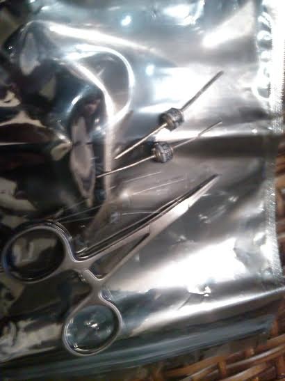

I cut the legs off right at the diode body, straighten them upright and clean and tape them off and use a little black RTV to seal off the hole and isolate the work area in case any solder should fall down off the new connection don't want it creating a short to anything.
Locking forceps are the ticket to hold the new parts together while your soldering them, just leave it a little high and seal over with RTV and your all done.

That is a great plan. I have already ordered the diode and potting resin. Thank you so much for the detailed plan.

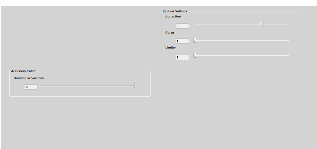

I need to review some service records for total numbers and I'll update this post with some more info, I have found this module in particular to have an issue after repairing the diode and I'll grab a data screenshot so you can see what I'm referring to.
On Edit:
There's been a total of eleven of these one year production 1997 GTX modules on my bench since I started a different record keeping process that captures internal data screenshots of the readable/writable programming functions of these modules.
Of those, five of them had lost the accessory power cutoff duration programming function and had simply reset themselves to a zero value when the diode was taken out.
Not a big deal, the fix is a simple swipe with the cursor to reset the value back to a maximum duration of 33 seconds but running the module without the programming value reset will result in it never shutting off power to the dash creating a constant battery draw and the ROM partition of the memory that stores total engine time running hours and minutes will tick away forever more.
If you notice your dash doesn't go to sleep after 30 seconds or so just shoot me a message you can ship that over and I'll reset the programming value for you.
There are three relevant data display screens in your module, this is the one displaying the duration cutoff programming and ignition timing correction value.
