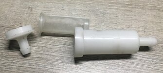

Anyway, a second "recommended" oil filter just happed to drop onto the wooden test bench (4"maybe) and this happened.
WTF!
Will not snap back together. Will use later on as to filter other oil though.
Is this the quality of? Occur often? This is no way, no how acceptable. Not rolling the dice here.
Is there an aluminum screw top filter housing for the mesh insert that is tried, trued & recommended out there in the community?
I can get fine mesh insert's all day long.
