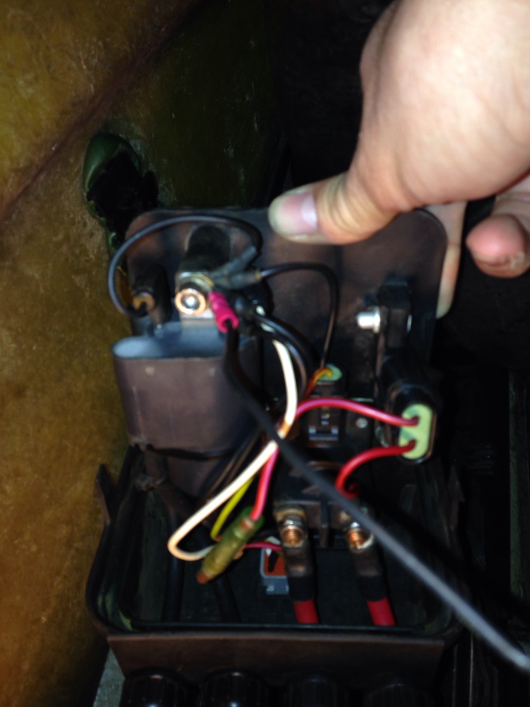

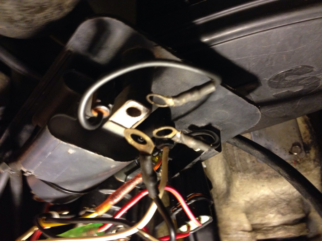

Ok, so the PO had a jumper wire that ran from the post at the bottom of the coil, to the point where the battery grounds on the engine.
Above is the coil end of the added wire.
I removed that wire.
I checked continuity to ground for the other wires at that bolt (disconnected/ individually) and found that only the coil ground (far left/upper in the pic below) showed continuity to the battery neg. terminal. All others were "open".
I am assuming this is correct but haven't looked at the diagrams to confirm.
