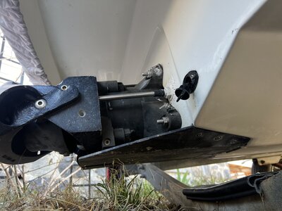

Here is a couple of pics of the jet pump assembly on my 1996 Sea-Doo sportster. I noticed I’m missing a bolt and nut that holds that nose cone to the pump. Any idea where I could get one from? Thanks

I usually seal the jet pump to the pump support with right stuff
You need to pull the drive out and make sure you have the groove in your driveshaft for the circlip to hold the stainless ring against the carbon seal which it should if it’s the original shaft
I’m not sure which missing bolt your referring to, but hardware you’ll have to source out somewhere, most of that stuff you can’t buy from a dealer unless they happen to have it in stock which is unlikely in most cases

I am missing the bolt and square nut that holds the nose cone to the pump. Top right of pump. Do you recommend staying away from the neoprene gasket that comes with a wear ring replacement kit? I believe that is what I used last time.
Also if I pull the ride plate should I use the same stuff to seal it? Thanks
Oh the plastic housing and nut? Yes they are still available PN. 269501943 They are about $9 CDN
I don’t use the neoprene seal, I just use right stuff on the pump, same thing for the ride shoe
Ok I’ll have to see if I can find one online. And I’ll give that stuff a shot when I get around to pulling it.
