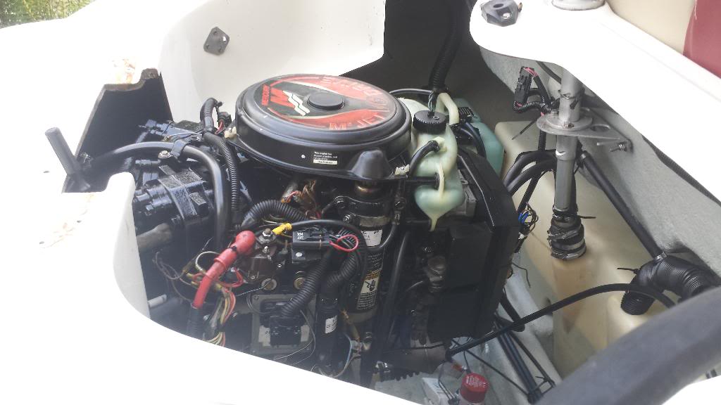

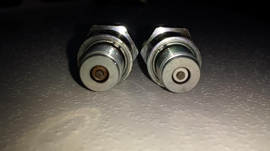

So I checked all the issues that could be wrong with the engine over the past 2 weeks and still had no luck. A buddy of mine came out to the water with me and we checked the compression, which all cylinders were at 140, along with coils that also had a good spark. The carbs were removed and were clean. The wear is in good shape, no out of the ordinary small scratches. I cant see the rpms as the gauges are not working, none of the 3 are. Could it be possible that the timing is off, should replace the cables? Could that be why the spark plugs have no burn marks on them in cylinders 4&5.

Ok sorry about that... I was having issues with the boat not leveling off at full throttle and it did not want to run any faster than 4-7 mph. I cant see the rpms because the gauges are not functioning. The 2 cylinders that I believe are not working are the top 2 port side. I have only come to this conclusion b/c all other cylinder spark plugs have burn marks and these 2 seem like they came right out the box. They are getting mixture in them, and compression is good along with spark. I do notice a vibration but believe that comes from those 2 cyl's not working correctly
Also... what cyl's are you calling 4 and 5? Those 2 cyl's don't really have anything to do with each other. (different carbs, different reeds, and I don't think the coils blast each other)
Both carbs seem to be fine when I removed them, almost like new. The boat has not been used much, as a matter of fact it hasnt been used for the last 3 years.

So I've looked for everywhere in the engine to try to find the problem and can't find it anywhere. I think I've done it all. I checked compression (140 psi) all around, good spark. Good stator, magneto was in specs. This is what I'm dealing with just to get a better idea. Carbs are good to. Could it also be to much oil in the mixture.
I might have found the issue. .. I was doing a simple start of thw engine and ran fresh water to cool and when I took out the sparks I found small drops on the spark. I have a leak in those 2. Is there a temporary fix that I could try in order to see if runs ok untill I open her up, or should I just open it anyway.
The clean plug tells me that cyl just isn't running for some reason. It's not going to be fuel, since the top carb also feeds the cyl on the other side.
Since the compression is good.... that would say there isn't an issue with the piston, ports, or reeds.
If it was my boat... I would get a simple "in-line" spark checker, and clip it on, and start the engine. I'm guessing, once the engine starts... you are loosing spark to those cyl's for some reason.
