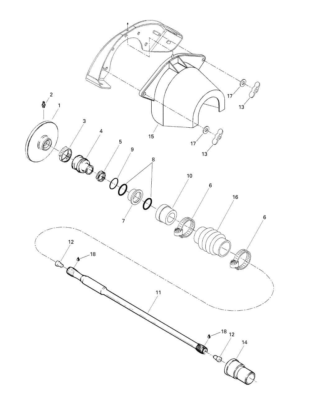

• Same lake put boat in and started up just to notice water gussing in around the boot.
• Took it back out and went on the forums and I ordered a complete shaft rebuilt kit less the shaft since the shaft splines were fine and shaft appeared true.
• Ordered new parts and replace accordion boot all three O rings, carbonite, and carrier bearing (believe what they are called and the front boot.
• My carbon piece was scarred badly and the boot was hard on both ends.
Week three:

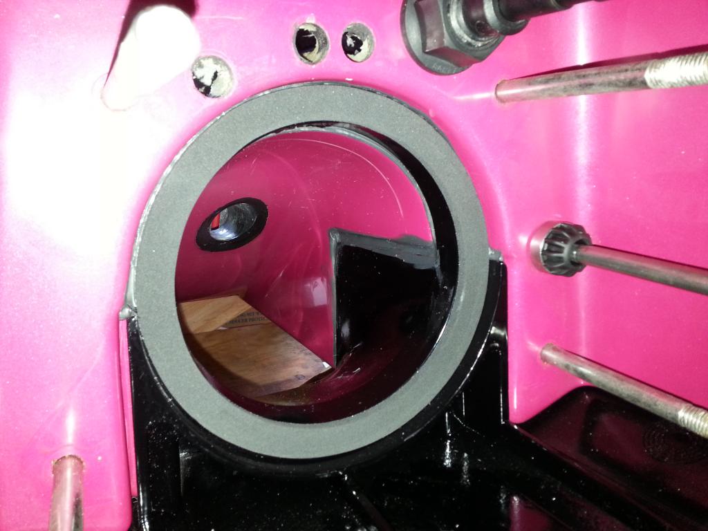

• Same lake put boat in started right up no leaks. Did notice the carrier bearing moving about a 1/16 inch in a vibrating motion.
• When I went to use full throttle at this time it almost got on plane before what felt like it was flooding. I believe if I had not backed down on throttle it would have died.
• Back to the dock called a good friend of mine up north that works on outboards and he said sounded like a carburation issue and I should have them rebuilt.
• I had another person tell me it is the neoprene seal between the outside drive unit and the hull and I should use a silicone to seal.
• Previous owner bypass the key unit and just installed what look like a simple clamp under the dash. Someone said that it is not activating the learning or junior mode??
I did not mine doing all the other stuff since I believe it needed it. I do not however want to continue to replace everything on the boat till it works. This is what is called a parts changer and not a mechanic. I can rip a Harley apart and put it back together blindfolded but this has be baffled. Your help is greatly appreciated in advance.
