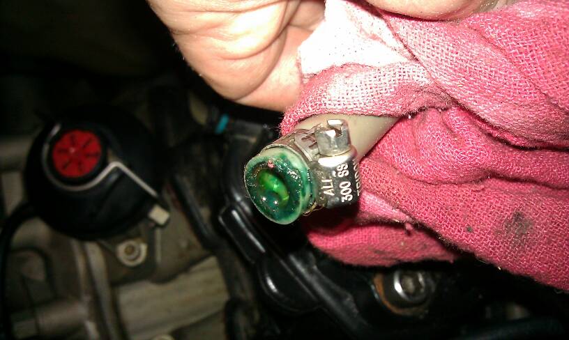

I took all the top lines off so far. On the selector side they aren't what I would call gummed up but there definitely wasn't much of an opening on the inside. I cleaned the selector out and getting ready to replace the top fuel lines or all the 5/16 diameter ones today. Looks like I have a bit more work to get the 1/4 inch lines off that run underneath to the carb
