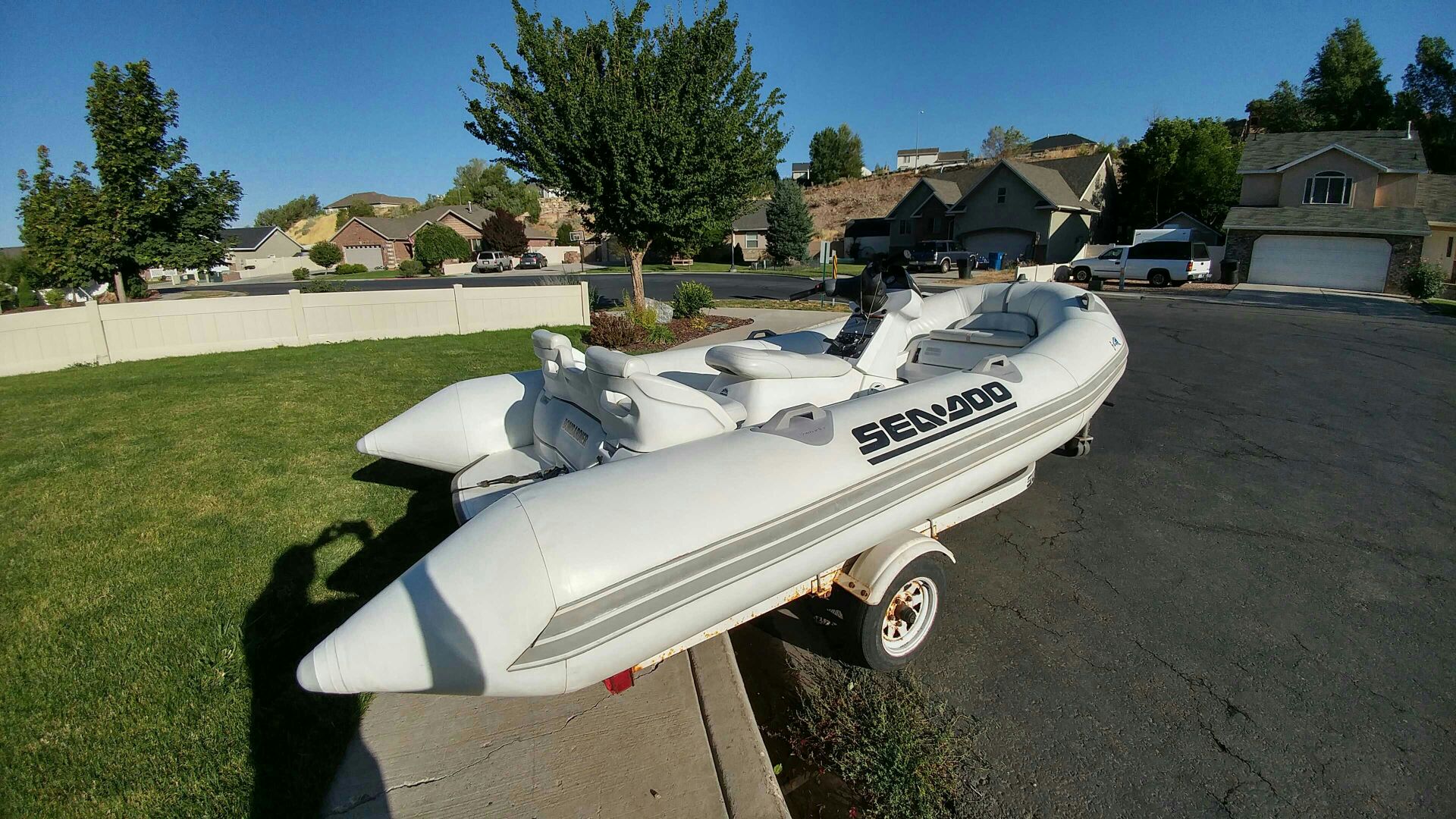

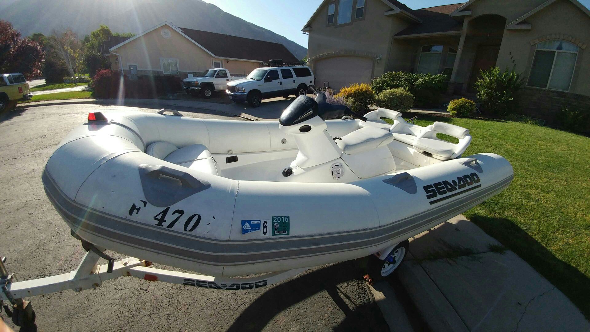

Hello all from forum newbie. Hoping to get some experienced / advice for both myself and to give to my mechanic. My 717 needs a refreshing. I'd much rather put the $800 towards a bigger engine than keep struggling to get on plane fully loaded.
We absolutely LOVE this Explorer and have had wonderful times as a family the last couple years. Still have younger kids and want to keep this around as long as possible.

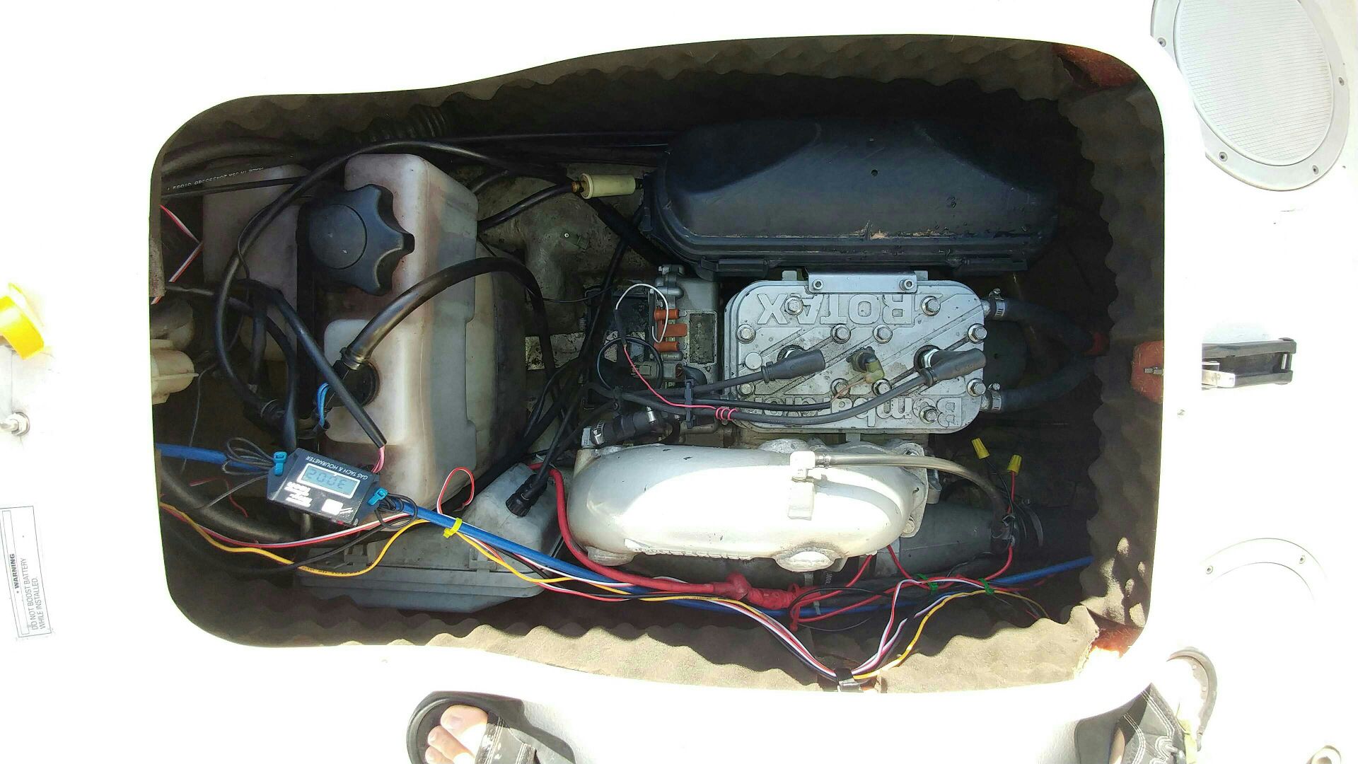

As you can see from pictures below, there is not much room in the Bilge. Would love the 951, but not sure if that's possible...... 150mm pump, exaust, ect.
I don't have doner boat yet, but want to start looking so work can be done this winter...(rate lower and more time available) [emoji6] Is the extra work for the 951 worth the additional 20 HP. I'm fine spending a bit more for a better long-term solution if it is possible.
We use our explorer as our runaround boat and for wakeboard, tube, weenie, and airchair. Have kids from 2 to 17 so want a good long-term solution. It's nice to have room to throw 5-6 kids in....and much safer.....will NEVER roll.
Right now with the 717, were pretty much always WOT. Already dropped impeller pitch to help with hole shot.

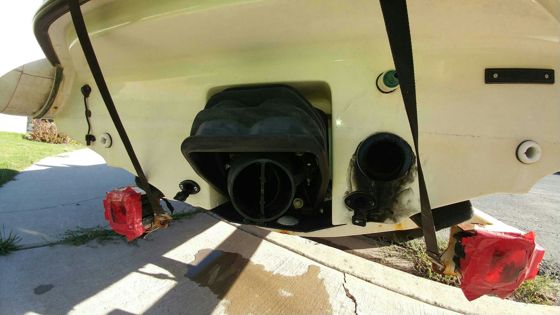

The 787 has a completely different foot print when it comes to bolting in. It has 3 motor mounts, no engine pan (that black plate at the bottom), would need a different computer (mpem).
So, in short, it would be easier to find a different boat. Is it impossible? No. Just some fiberglass work, wiring, and maybe new cables.
A new engine will wake up a boat. The 720 you have might be tired. Do a compression test, check to make sure the wear ring is not worn out.
