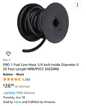

And yes the fuel lines are 1/4” ID, top rated ones on Amazon, probably middle of the road in terms of quality. However, have you heard of fuel lines causing gas to turn orange? When I open up my carb, the fuel is orange instead of clear. The fuel in the filter is clear. But again, the GTI has the same fuel lines and doesn’t have issues.
That’s a great idea, I will definitely try bypassing those next and see what happens.
Yes I have, I ordered the same line from amazon and then read the reviews Lol, turns the fuel orange and three lines get brittle and crack in months.
