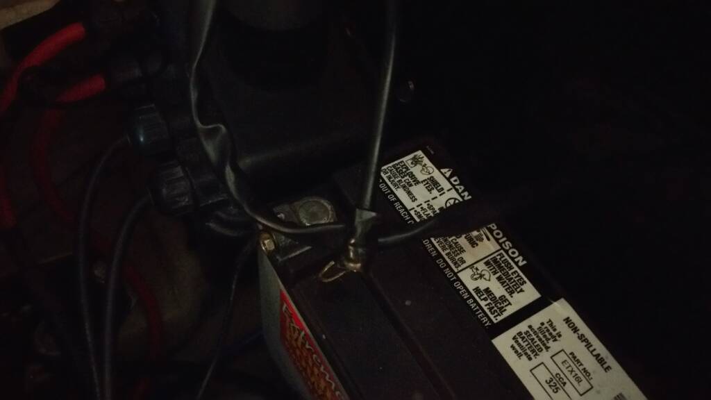

This has always bothered me. Looks like someone put a crap connector with some electrical tape. Where does that wire go, is it replaceable, if not can I join some wire there to make it longer with a better connector? If so what gauge?
If it's the rear Coil box I'd be using heat shrink tubing and securing it to the negative battery cable.... I've destroyed at least one CDI by having that cable loose!
Sent from my iPad using Tapatalk
Yup that's what it is. I've never left it unconnected on the negative terminal, just want to clean it up and put a better connector on there. This one looks like it has seen better days.
