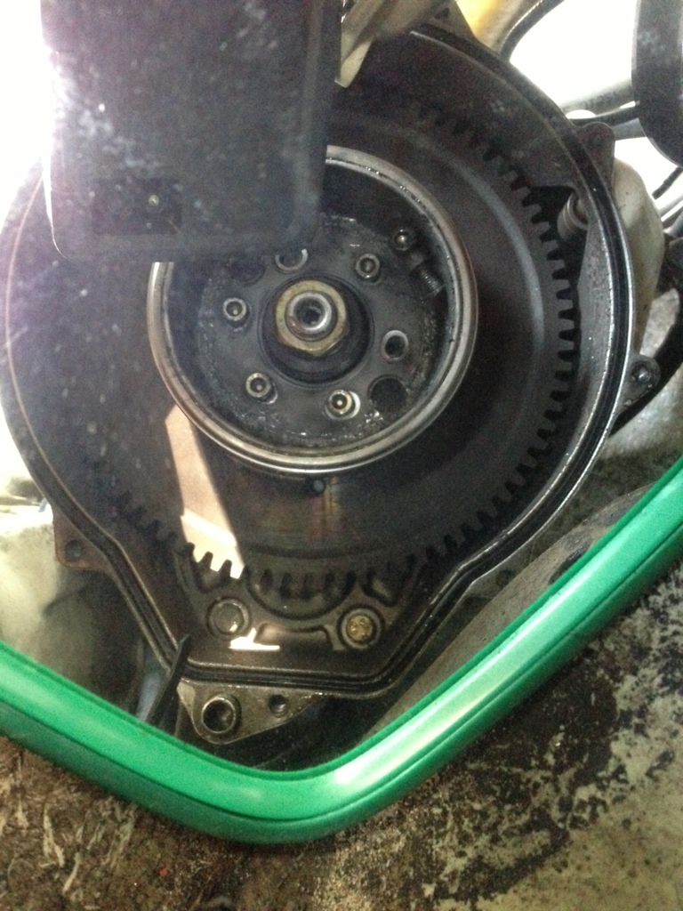

For those still following the thread here's an update

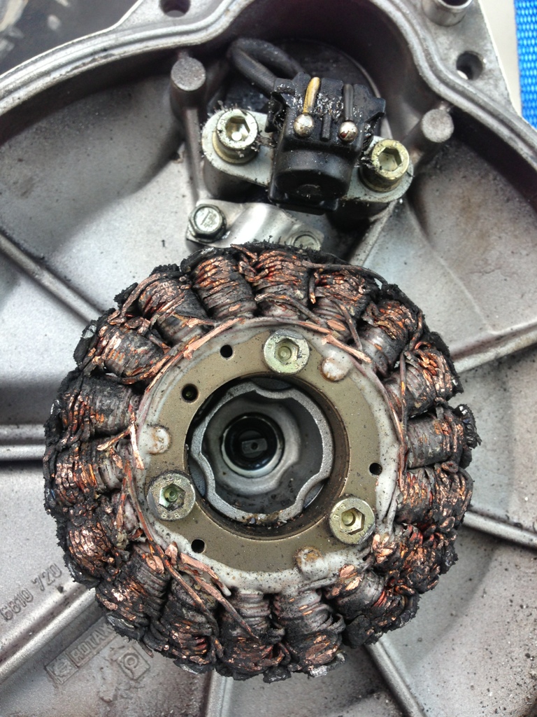

I just found a closed circuit (ground). On the 6 pin connector on the engine going to the stator there is a full out ground between 2 of the yellow wires and the engine ground or block. From what I've read this is supposed to always be open circuit. I'm going to go ahead and attempt to pull the stator with the engine still in the machine...... Arggg
Yep, the dreaded stator short to ground. A short to ground on a yellow stator wire is cause for concern and a good reason to consider pulling the stator cover. I hope to never see this on my 951 engine.

Problem solved?!? Drumroll please...
^^ Aw, you make it sound like that's bad.. lol. Those loose bolts just serve as counterweights..
Nice find though. Your bro in law owes you a few cases of good beer. Tell him we all think so.
I'd try and find good used parts. Minnetonka4me might have what you need.
