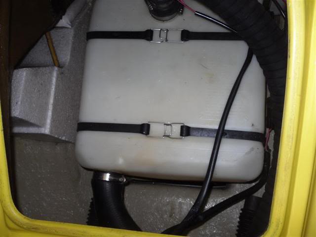

	 but now I won't be avoiding some of the group runs that soflariders has been having due to the fact that I was limited to planning rides less than 40 miles.   With the large tank my range should be closer to 55+ if I don't ride hard, and If i can pack 5 gal's on a buddy's rack i can finally make the longer runs that the 4 stroker guys are making.
  but now I won't be avoiding some of the group runs that soflariders has been having due to the fact that I was limited to planning rides less than 40 miles.   With the large tank my range should be closer to 55+ if I don't ride hard, and If i can pack 5 gal's on a buddy's rack i can finally make the longer runs that the 4 stroker guys are making.Spimothy, where oh where are your outer wears? I got mine from Hot Products for $15 ea. Those pics are great. I'm driving down there to ride with you guys some day but I still can't get too far away from a 5 gallon can.

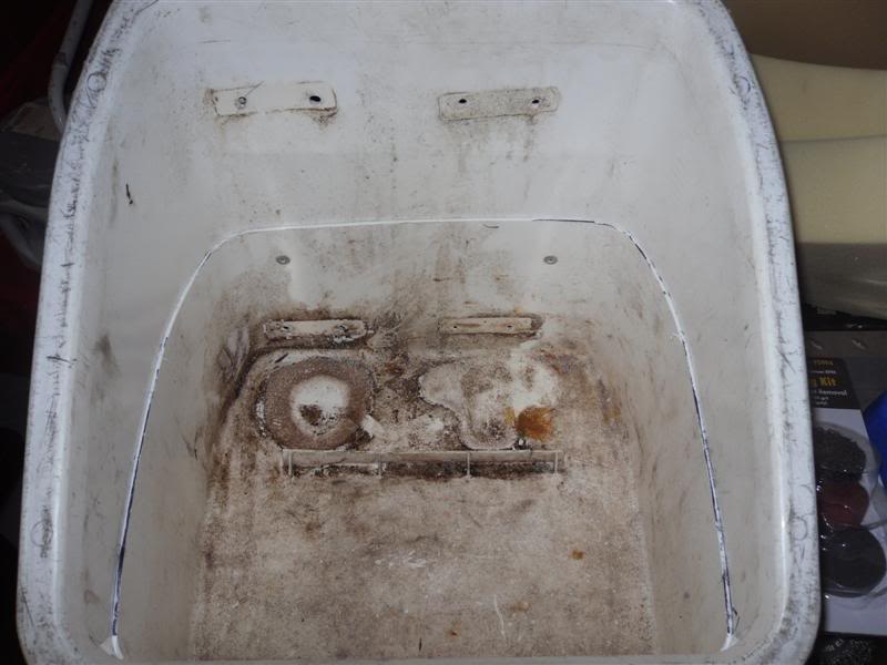

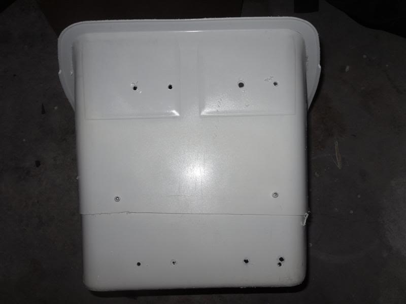

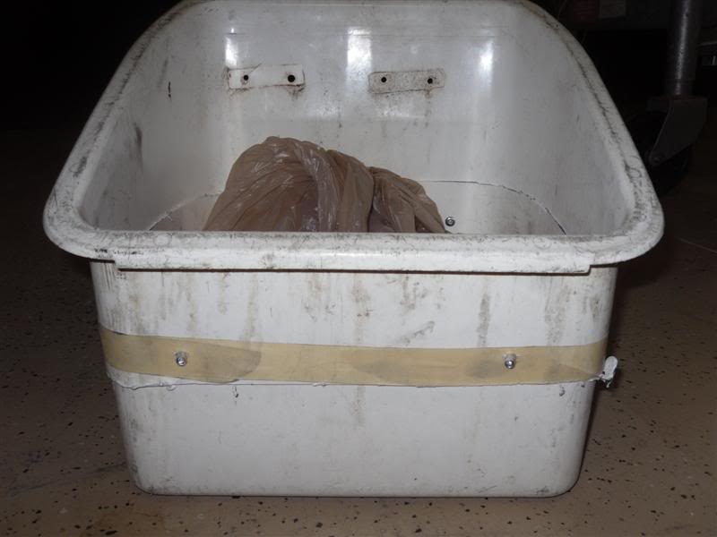

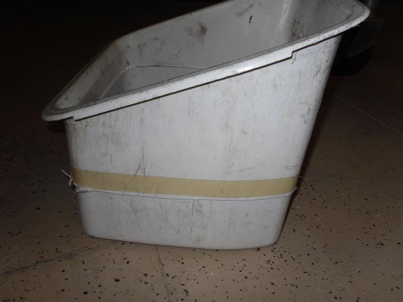

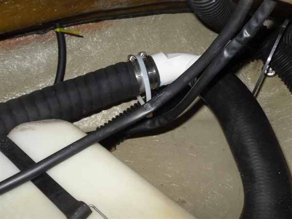

 )Tanks soo much for the help and the refrance pictures .Are you still able to fit the purple storage tubes in the bucket?the big tank fits in there, but just barely...the engine has to go... and you really have to shove it in there.. and modify the fuel filler, i used 3 feet of flex fuel filler hose, (quite pricey) a small 1 1/2" pvc 45, double clamped and another foot of regular fuel filler hose to connect it to the tank.
the fuel filler had to run around the back and opposite side to keep it flowing smoothly and avoid backsplash when filling at the pump, it was the long way around but it back splashed when i tried to make the tight turns and stay on the right side of the hull.

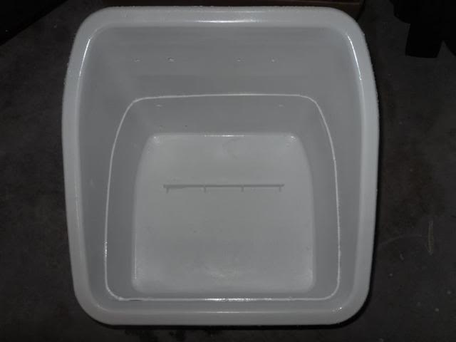

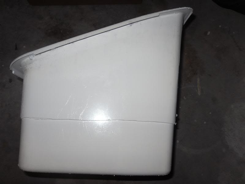

the bucket modification was quite simple, i found an old nasty bin rather than experiment with a nice one.
drill out the rivets holding the purple storage tubes, stick a piece of tape to get a straight line, and cut through the bin the whole way around, as I said b4, it will almost slip back together, and once I heated one corner to make it pliable enough it slipped in fairly easily with an extra pair of hands, 4 rivets and a coat of paint and it looked great. 15 minutes including the first coat of paint, added 2 coats of white appliance epoxy and it looks brand new !
after pressure washing & painting...
(i just love white epoxy paint !)

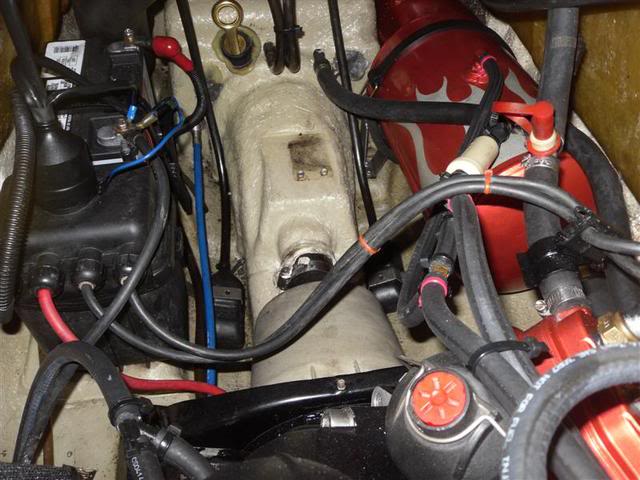

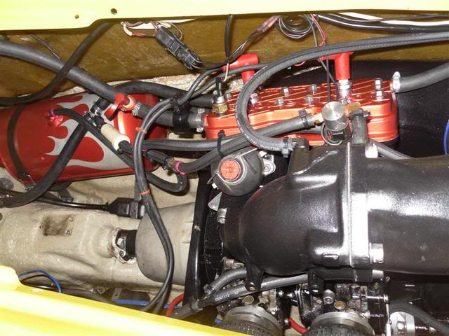

sorry if this is a dumb question because i am new to jetskis but what the hell is that tube/cylinder thing in the picture of your engine compartment because it looks sweet!!!!
	Lol yea that was the one I think it looks sweet is that had to take off and put back on because I would be interested in doing that for $50 during the off season.hmmm, i'm guessing your looking at the waterbox (muffler), thats just a standard ugly purple x4 stock waterbox that has been painted by a friend of mine who likes to tinker with paint so I gave him my head and box since I wanted a splash of color (if you meant something else, tell me what pic you were referring to lol)
Here's a pic of it before I installed it in the hull. It gives a better view the box.
not sure if he was joking but he told me he'd do box's for others for $50 + shipping both ways,,, all I did was bead blast it and take it to him, picked it up a few days later.
	Alright just let me know if he because I'm in new York and since your in Florida it shouldn't be too bad of a shipping costactually its easier to take off than the carbs ! just loosen the clamps on the top (exhaust hose) and lower end of the pipe (coupler), and it should slide back a couple inches then up and right out with a little wiggling.. I'll have to ask him if he's serious about painting some, after I saw the finished product I gladly gave him $50 to cover materials and time. duly noted, it looks much better in the pic's than it does in person since the waterbox generally has some scuffs, dings, and welds on it, but once its installed in the hull, you don't see any of the imperfections at all.
you can do it yourself in any color just by using some high heat engine paint (autozone).
here's another pic of one in solid grey that the same guy did before he got the crazy idea to do flames. And another pic of his engine/head, he did the whole engine in copper and polished the head to a chrome finish... looks great, but a b1tch to keep clean.
