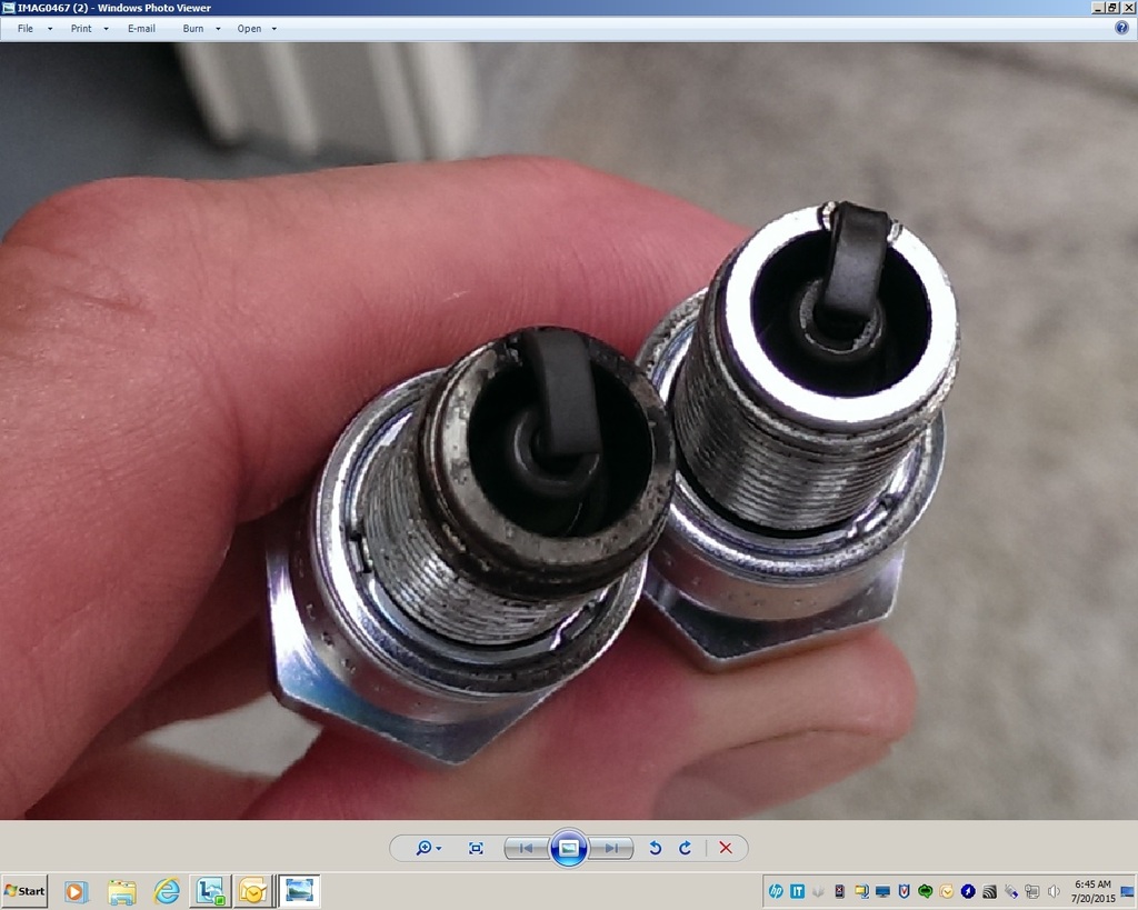

Stumped again! Got the new 130 mains and installed, settings H 1/8 out, L 1 3/4, and took it out yesterday. Other than a slight hesitation on the low end it ran well for 35-45 minutes total with breaks in between. After the last break of about 20 minutes it starts, idles then dies with any throttle....called it a day. Below are the plugs which were new. One on the left is the mag plug. Thoughts?
They look ok to me. But the MAG plug is oily. I wonder if you have a leak on the crank?

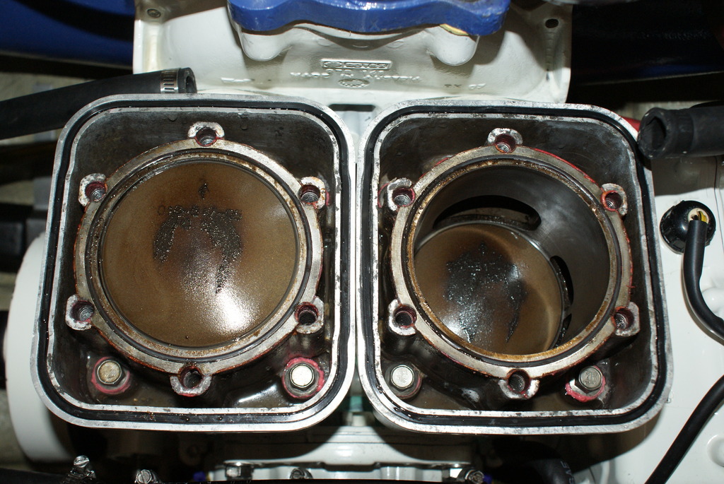

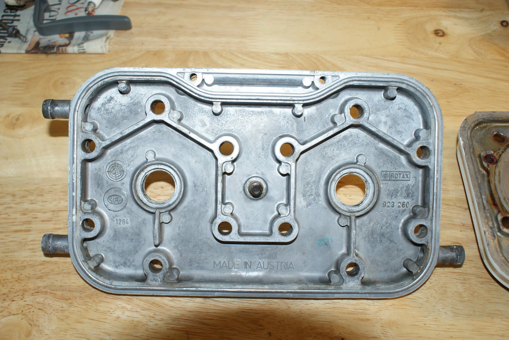

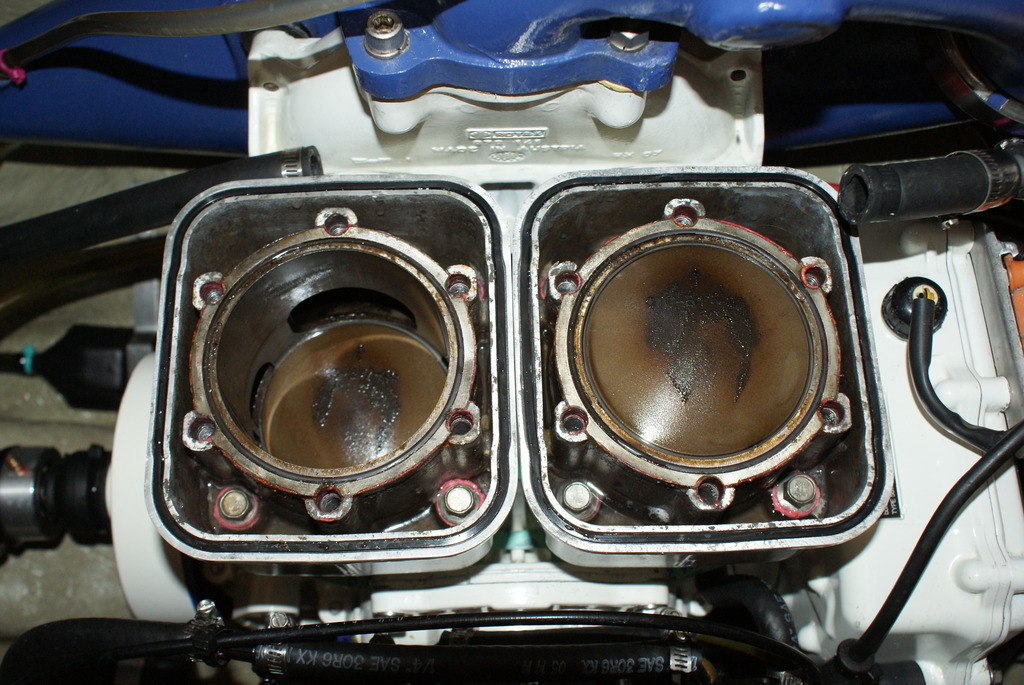

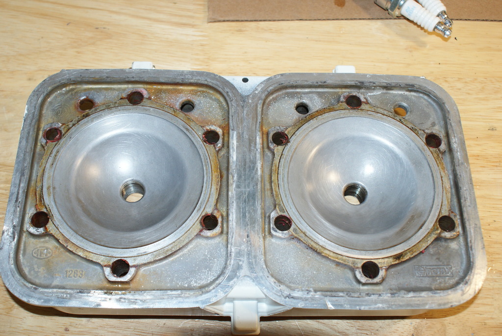

Pulled the cylinder head and cover.
The motor has maybe 2.5 hours on it. Any thoughts based on the above pics? Thanks guys.
Curious why I there's no carbon build up on the cylinder dome and only the piston crowns? Also, when I had it out Sunday I felt the cylinders and each were very hot could barely keep my hand on for just second.....I have checked the passages and I have water coming out the pee hole. This is getting the best of me :(
Curious why I there's no carbon build up on the cylinder dome and only the piston crowns? .................:(
That's because it's crazy rich still. OR... you are getting water in the engine some how.
Basically... you will build carbon at you burn the fuel an oil... right??
OK, as you get "Wet/Cool" fuel in the top half of the engine, you will clean the piston crown. This cleaning process will show up by the port. The pattern it produces is known as "Piston Wash". It's a better way of reading how an engine is running, over just looking at plugs. But, in practice... it takes a bore scope, since you don't want to take an engine apart at the lake while tuning.
OK.... well...................... Ummmmm................................
