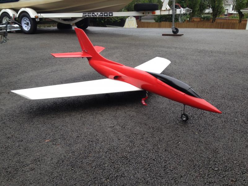

Nice to have other RC guys here. (it's a nasty habit, LOL) Lot's of good building and mod technic comes from that realm.
Sorry to get off topic... but thought you would like it.
It is a bad habit. I would be too embarrassed to post my fleet roster, like a heroin addict showing their track marks lol
Our field does not allow turbines (burns the nice grass, no asphalt), so I haven't toyed with them yet, looks like you are well deep into that world:)
Here is a shot from last weekend catching a Funcub flight while the family was still sleeping (before putting the boat in.... ) Electric foamies are good for not waking up the lake at 6am. :)
I like high wing sport planes at the club, Clipped Cubs, Decathlons, taylorcraft etc. Building a 50cc clipped cub right now. Anyway there are other forums for this hahaha Good to see other RC'rs are on here too!
