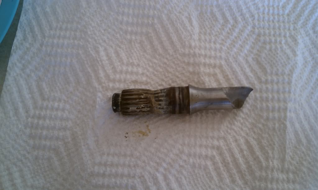

So I'm breaking in the motor...still only goin max 90% throttle. Everythings goin fine when boom. Instantly not moving and the motor just seems real rough.
So I get towed back to the ramp pull it out take the jetpump off and see that my driveshaft is snapped in two. I can still move the impeller with my pinky finger no problem. So it leads me to believe it was just bad luck? But it also seems strange and makes me wonder if there is another problem. How easy should this impeller move? And anyone have any experience with snapped driveshafts?
Edit: Engine runs fine once the drive shaft was pulled out.
