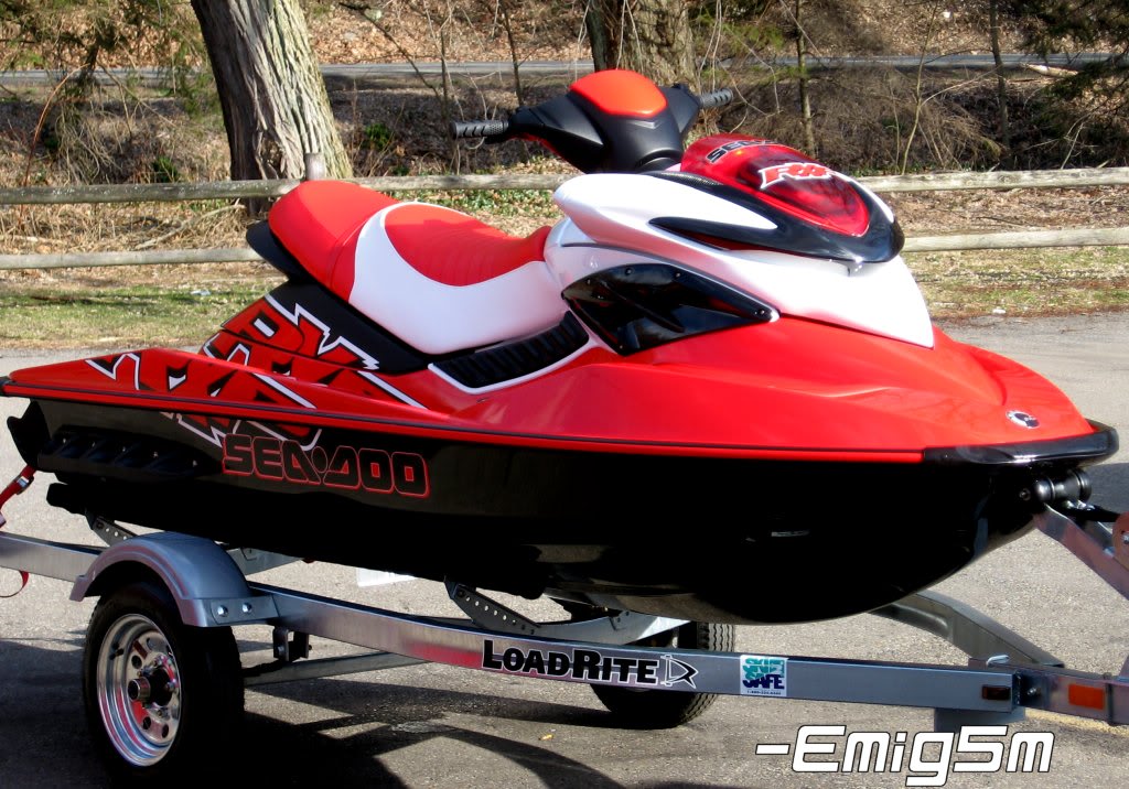

Well good luck with your new 09, have any pics of it? Here's my brand new 08 left over....
