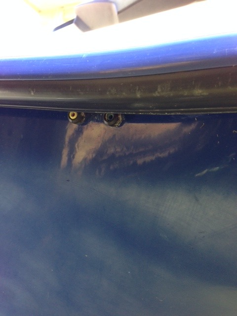

Where should these vents hook up to? I'm thinking some sort of bilge vent. Only one of them isn't hooked up...unfortunately I dont remember which one:

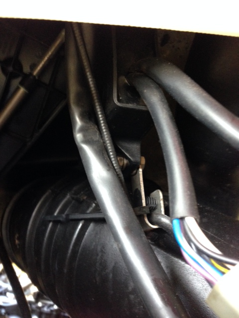

This plug is on the starbord side, directly where your rear end would go......

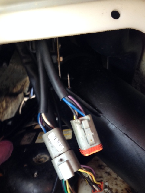

These two could be related and I'm missing some sort of intermediary harness. Directly under the dash,from the front of the boat looking back with the fire extinguisher cover removed

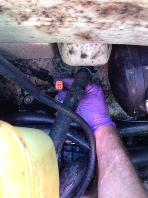

And possibly the worst picture I could have possibly taken. A little black box directly under the dash with two plugs/wiring harness coming off of it. What is it and where does it go?

1st picture the 2 vents....1 is probably a battery vent for the old time vented batteries....you shouldn't have one of these batteries, so just leave it blank. Look for a tube, that's just laying in the hull, if you want to. Other vent could lead to the gas tank. Look on top of the fuel baffle and see if any nipple is not connected to a tube. this lets your tank breathe into the open air instead of your hull.

I can answer all your questions but may need a little more info for some. 1st pic, the two vents are one for the battery and one for the fuel tank. 2nd pic, this harness looks to be in the wrong location, the only connector down there should be the speed/water temp sensor but that is only a 3 wire connector. I suspect this is your EMS power connector and should be up by your ECU. what are the wire colors? 3rd pic, looks to be part of your gauge harness but is it a 4 wire connector? and where does each connector come from? need wire colors. 4th pic, this is your DESS module and goes inline with your 6 wire connector dash harness.
