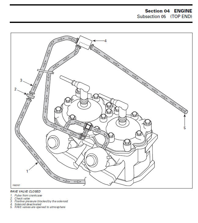

Mind my ignorance but what do the RAVE valves do ?

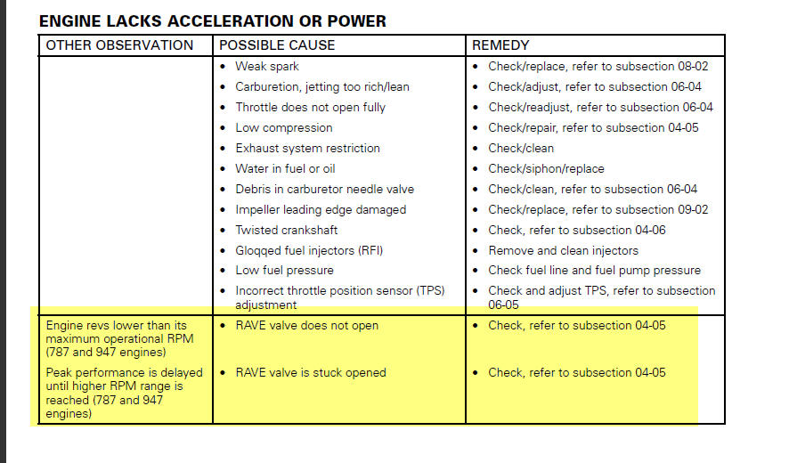

Also, the Rave Solenoids may not be functioning properly
and check for anything else that could be restricting exhaust flow

Did you get all that from the service manual ?
