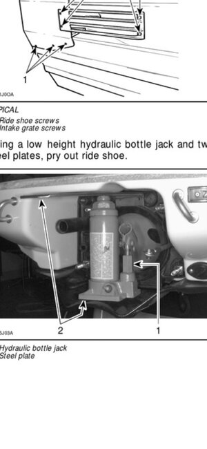

I would use a small bottle Jack set on the top side of the ride plate and use a piece of wood to
Press against the fiberglass on the top side and put a bit of pressure on the ride plate, apply enough pressure to start stretching the sealant but not too much then cut any sealant you can get at with a knife, apply a little more pressure, don’t try to rush it or you’ll break the ride shoe. Of course make sure you have all the hardware out first.
Once you get the plate off you will probably notice where it was leaking.
See the pic for the bottle Jack placement
