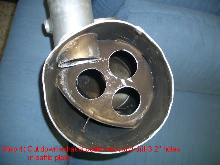

waterbox @ Jpipe.jpgI have a 2005 rxt with a Riva stage 3 kit and an issue regarding the waterbox. I had it out this weekend, and it ran fine until it showed a high heat alert which shut me down. I pulled the Jpipe to check and make sure the holes in the bottom of it were not plugged (had this problem last year), and just happened to look into the waterbox. Since I am not sure how to describe what I saw, I am going to attempt to post this photo looking down the Jpipe connection hole. It looks to me like their is a double bottom to the waterbox and that a hole is blasted through the one bottom and you can see through to the waterbox bottom. Not sure where pieces went, or if this is usual.
My main question is...will this cause a performance problem due to unstable design of water flow, should the box be changed? Does it effect anything.... since it does not leak....any clues?

The picture shows the inside of a stock water box. The baffle has been had holes drilled into it to aid flow.
I seem to remember instances of the baffle becoming disengaged from the water box and bouncing around inside...sometimes blocking the exhuast exit and over heating...sometimes causing a blowout and flooding the engine compartment.
Now might be a good time to go with a good aftermarket waterbox and go thru hull exhaust....or just get a new oem wb and call it good.

Yes...same. This pic is from a thread detailing a "shorty water box mod".
The mod was created not for performance but for ease of removing the sc. Now..there is some small benifit from going thru hull exhaust with a shorty water box. But it isn't all that much. It does make the machine sound pretty badazz. while at the same time freeing up space inside the hull for an ex/ic.

Wow! Looks like you need a new waterbox. Did you find where the missing baffle piece went? Looks like it's pretty big, may have blocked the exhause somewhere like you said. That's crazy that it broke out like that!
Now I wanna check my 2006 RXT's waterbox and make sure it's ok inside! Eeek!
