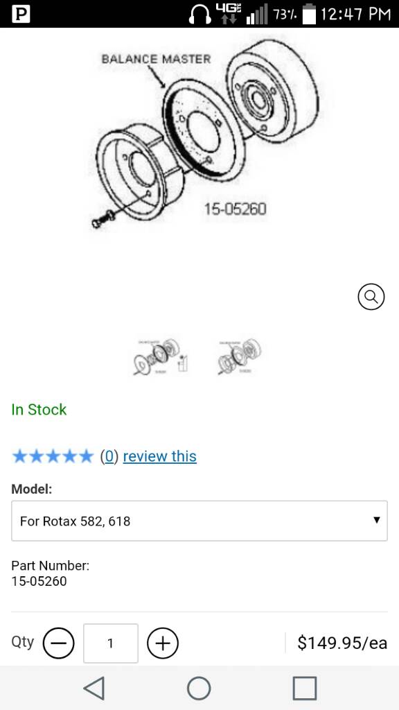

I found these 582 ballencers on line kinda cheap too.. Are these the style people where using? If so that maybe fairly easy to create a 720 pto, may even be able to use a wsm pto and bolt it to will little to non latheing...
