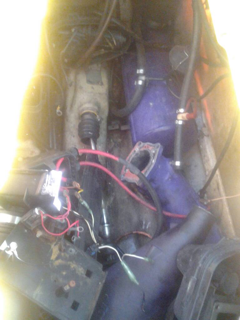

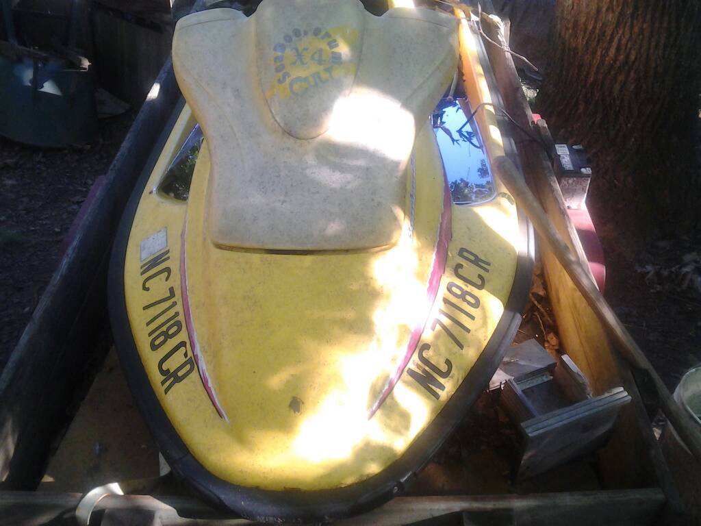

Back last November my house caught fire and to make a long story short, the fire was right above where I kept my skis in the winter. All the skis did not get damaged, aside from ash and soot, except for my xp. Coals burned the seat and melted insulation coated the hull.
For the reconstruction I had to move it outside where it had to sit all winter, the only thing I had time to do was peel the melted insulation off, but still she's pretty sad looking having set all winter with no protection.

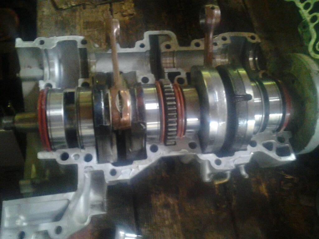

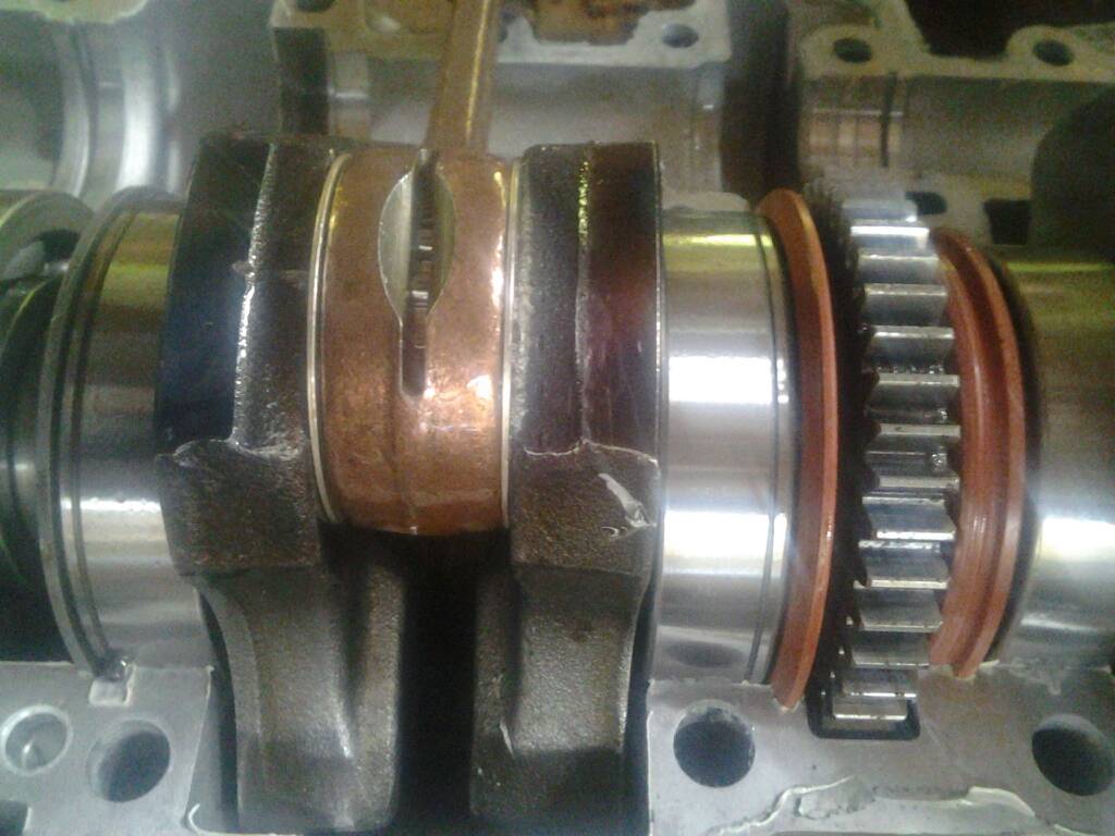

So as the title says I'll taking a 951 and building it to a 1020. That all starts with this: a 6mm stroked crank.

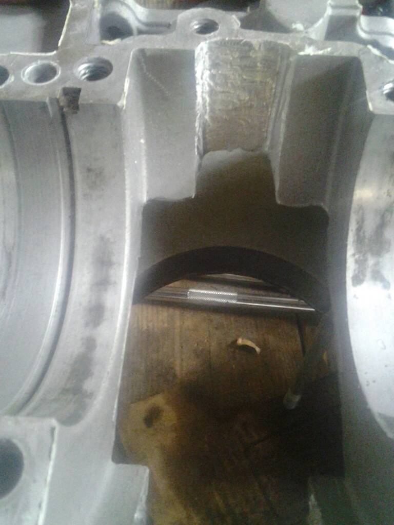

Now the cases had to be clearanced to clear the rods with the new stoke.

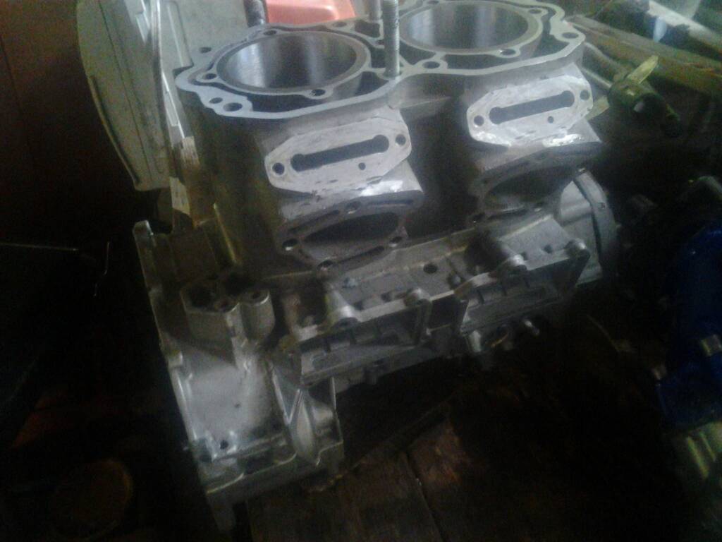

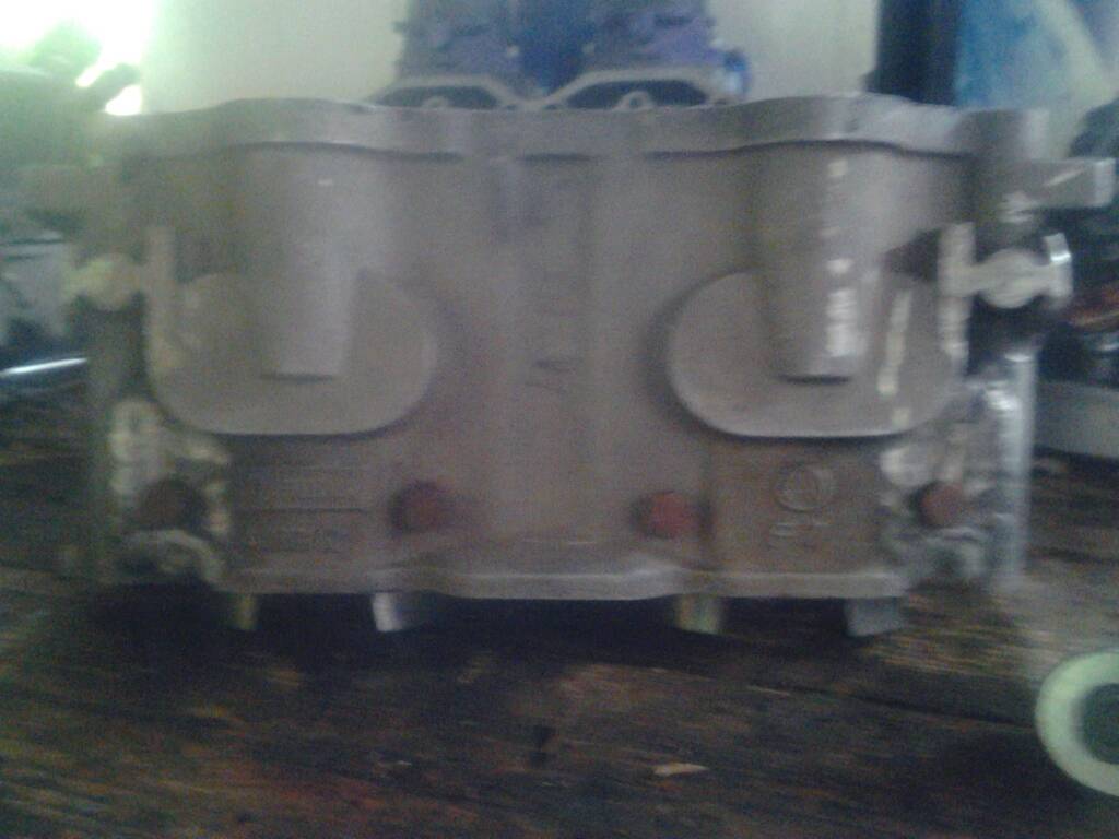

The Reed tunnels have also been ported
Installed a new counter balance shaft.
Then I set the case halves together so I could test fit one of my finds..

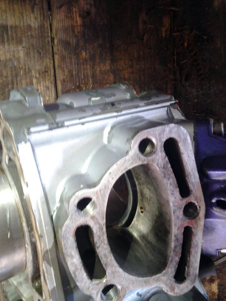

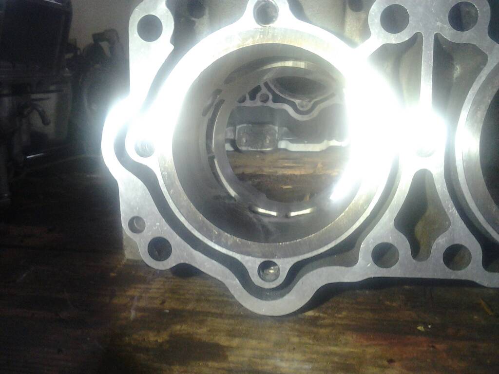

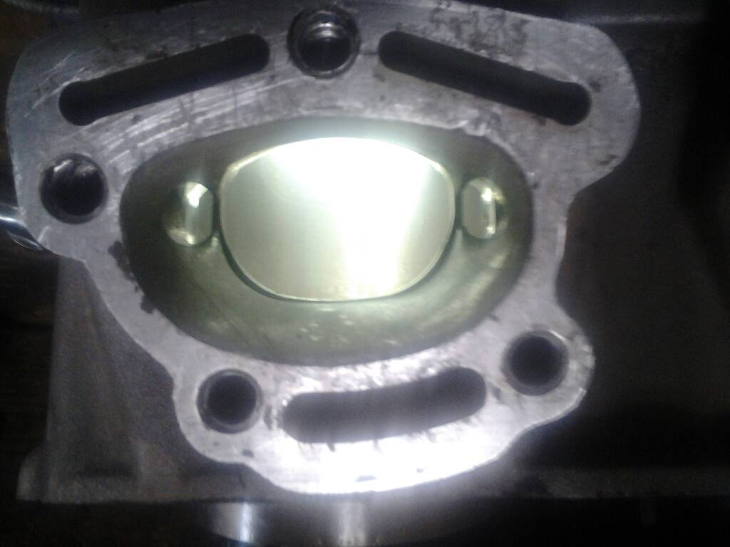

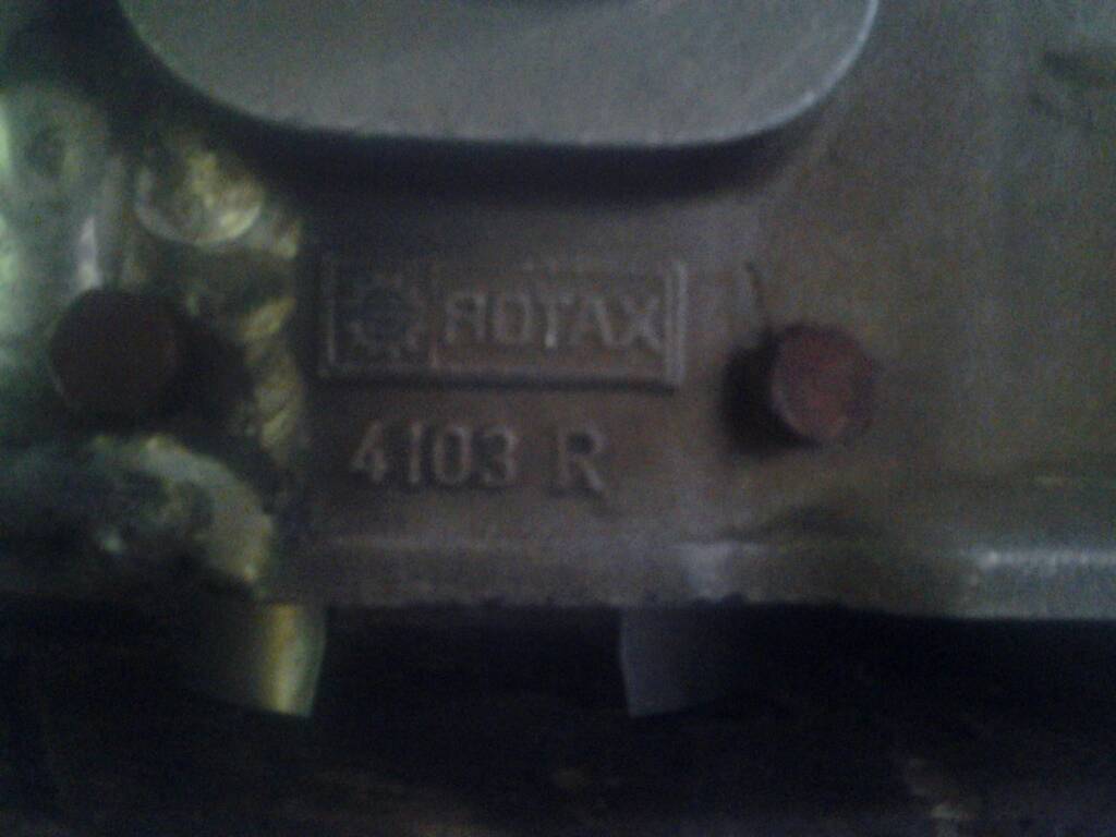

Now these where truly a find. They are 951 "R" cylinders. Developed on the 97.5 white cases, these are rated at 175hp on a 2mm stroke crank. They where meant to be a prototype that was supposed to hit mass production in 99. However with the epa cracking down on the industry there development was scrapped in favor of the 4tec and they where only distributed to the factory sponsored race teams.
In the next pics you can see the three exhaust ports.
Now custom sleeves have been made for these, bored and pressed in so that I can run these in them: single ring oem racing Pistons.
The down side to using these Pistons is that they're only gonna last 50 hours before they'll need new rings.

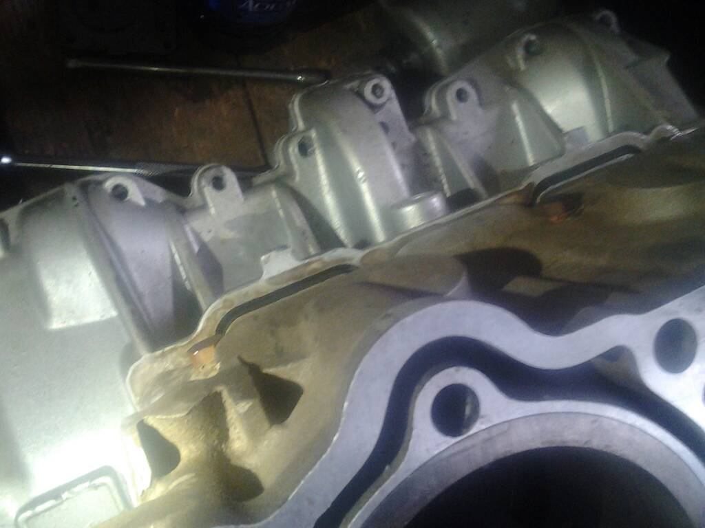

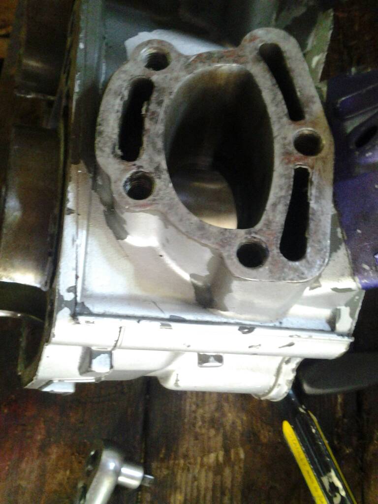

I put the cases together and slipped the cylinders on to see how much of the water jacket I'm going to have to fill, since these cylinders where made for the white cases and I'm using silver cases.
Now tomorrow, if I find the time, I can hopefully run to parts store for some hondo bond and get the cases together for good. May even get the Pistons in.

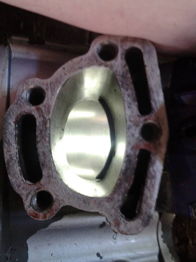

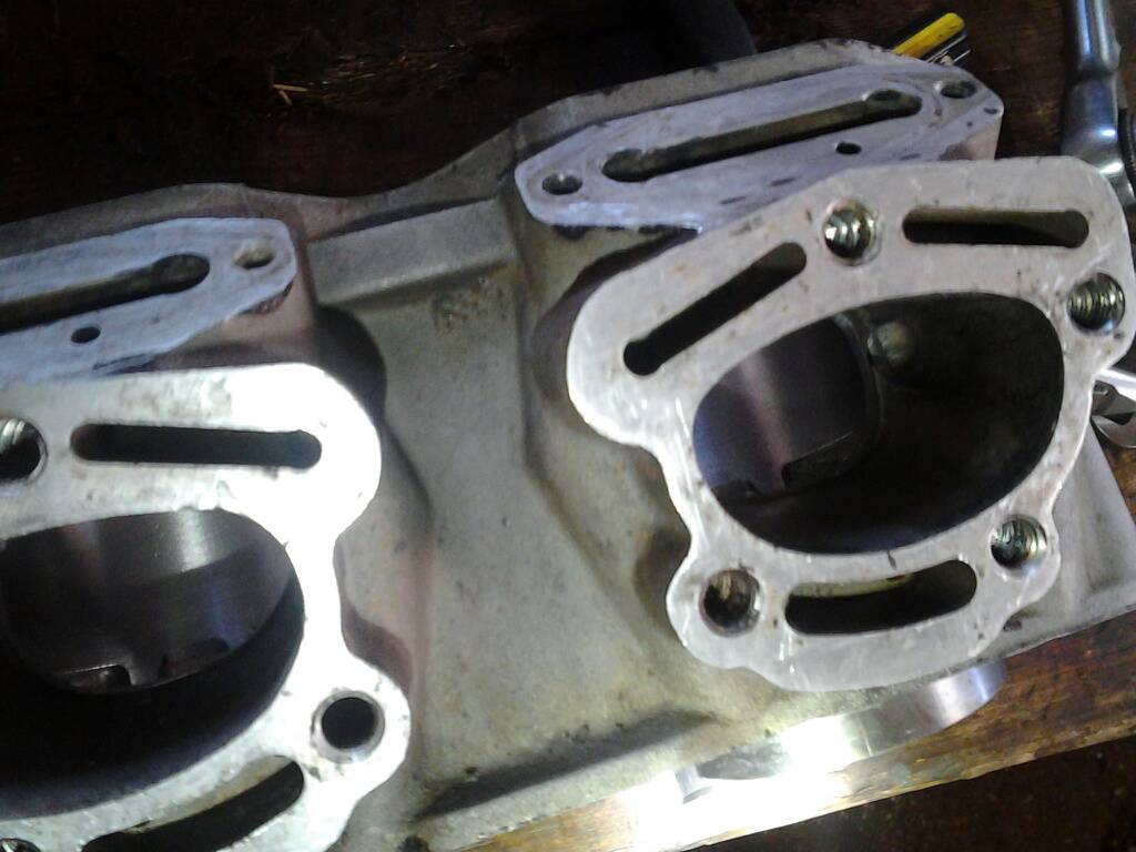

The R cylinders can't be cloned, from what I've heard, Mel Miller tried and failed. There is not enough material on stock cylinders between the exhaust port and the water jacket. Here's some pics showing the differences.
Vs stock
They have however already been mapped by advance sleeve in oh and I could probably get a hold of a copy of it.

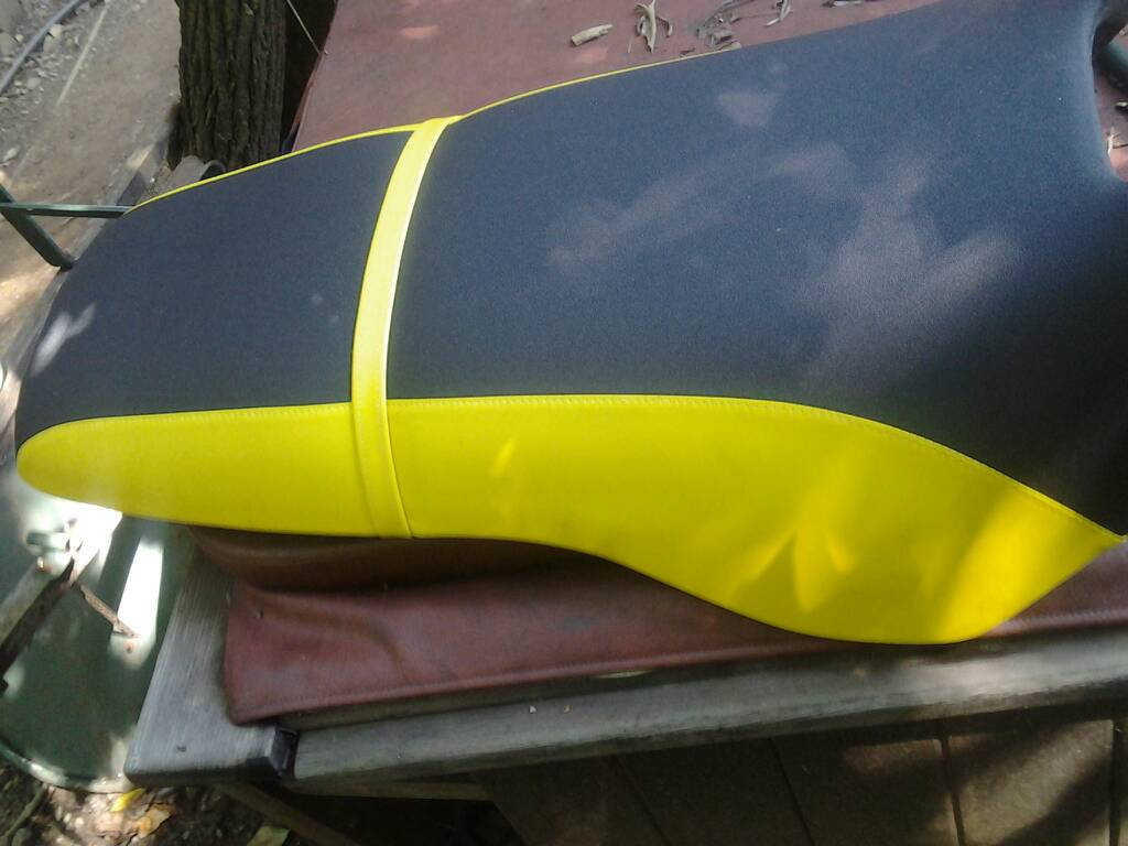

So I didn't sleep much at all last night and have been basically worthless all day, however, I did go pick up my seat from my upholstery guy. He forgot to add the foam riser to make it a hump seat like I wanted but for the price he charged me I'm not gonna complain too much.
Over all I'm pretty happy with it, if later I need a hump I've got another seat I can take to him and sell this one later down the road.

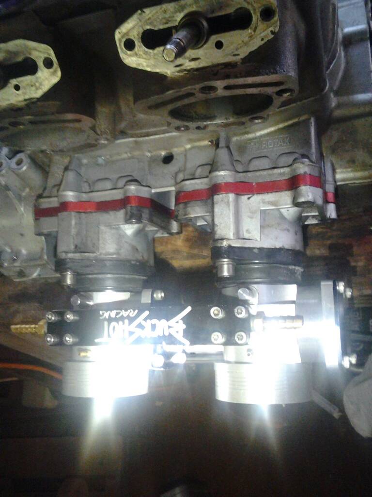

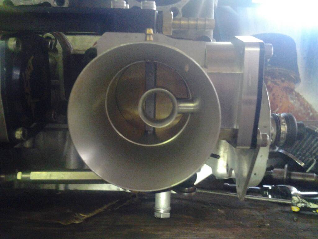

And I'll go ahead and show what's gonna fuel this beast: 50mm buckshot carbs.

what seat cover is that?
