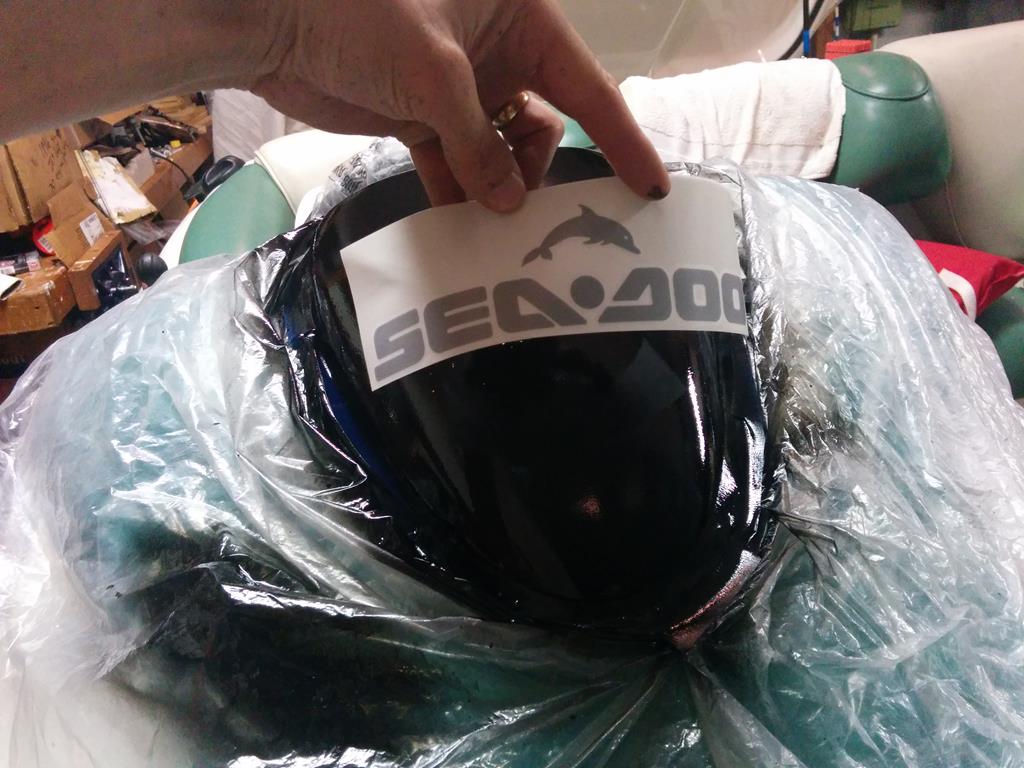

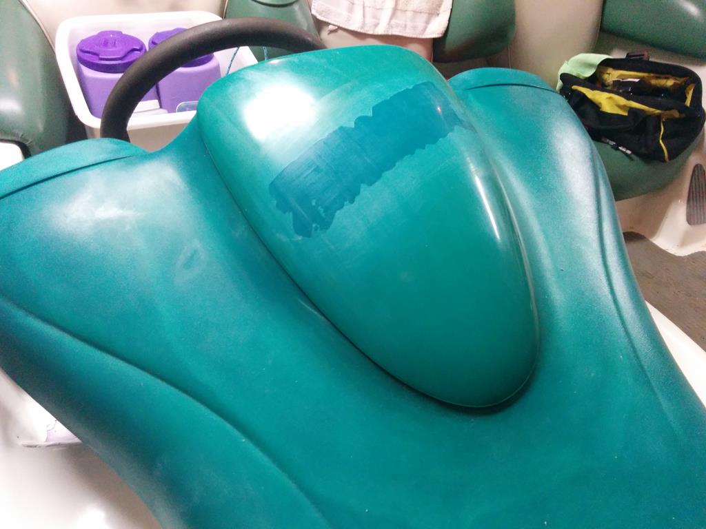

Also, I acid washed the starboard hull tonight, buffed it, wiped down with lacquer thinner, sprayed with a bit of water with a little soap in it, and applied the remaining hull side "SEA DOO" sticker. It went on MUCH smoother wet than the other one did dry.
And I painted the little bump on the green hatch cover over the helm with some gloss black paint. I have a silver SEA DOO sticker ready to put on in a day or so when it has cured. I put the silver SEA DOO bullet stickers on the trailer last night... so no more pastel pink SEA DOO decals! Tomorrow I'll reinstall the exhaust and prep the boat for the ride to the lake later this week..
With all of the buffing and wiping down with lacquer thinner, I have to remember to put a layer or 3 of wax on the boat soon to protect the freshly polished and unprotected gel.
