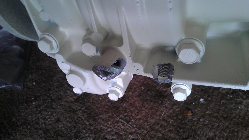

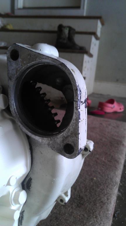

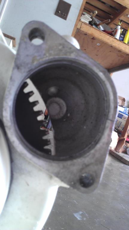

Not so great news! Either someone at SES or UPS must have dropped it, as I found a piece of one of the bottom standoffs in the bottom of the shipping container, and the starter housing is dented and cracked.
So, it will go back in the crate and back to SES tomorrow.
Pictures:
Partially crushed stand-off with the missing piece sitting to the right

BTW... I emailed Tom at SES the pictures above. He called me and said I could try to dremmel out the hole to make the starter fit or send it back. He said he could send me a new housing, but that the main seal is behind it, so he would rather get the whole thing back so he can pressure test it before I install it.
I was leaning towards getting out my die grinder and trying to make the starter fit, but since the plan is to drive it enough to be sure that it works, then sell it, I don't want a shoddy repair in there that might bite the next person.
