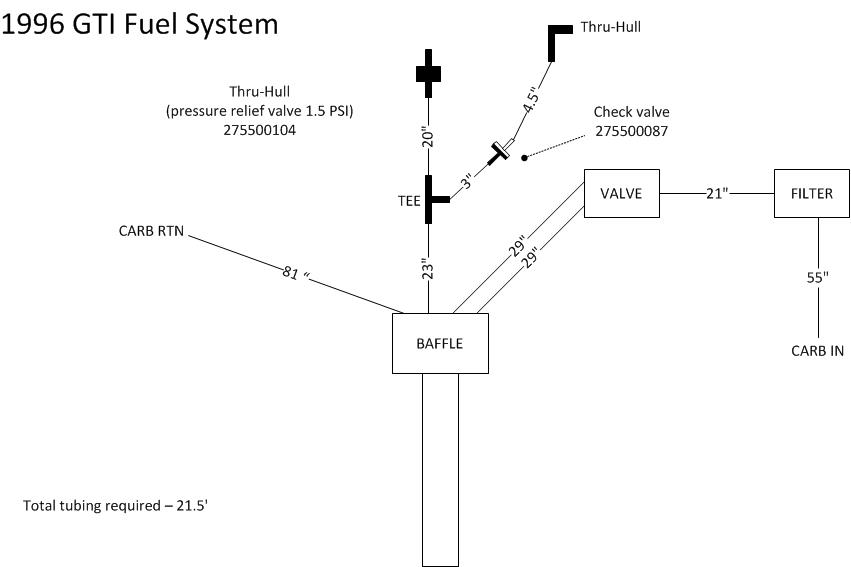

if everything is hooked up correctly, and the fuel filter bowl popped off of the housing when adding compressed air to the return line, I'm betting you have at least two problems:
1. The output side of the (damaged) fuel filter housing is clogged.
2. The pressure relief valve is not working correctly. It should have opened long before the fuel filter bowl popped. You'll want to fix this - it's a safety issue that can lead to an explosion.
Here's a diagram.
I'd recommend pulling everything back out and starting over since you have multiple issues.
During assembly, check the following:
- Vent assembly:
-verify the check valve, you should be able to blow air into the tank, but not the other direction.
-make sure the pressure relief valve opens at the correct pressure.
- blow air through the return line. This will verify that the baffle is not clogged.
- blow air through the "carb in' line with the fuel selector in all three positions. Make sure you feel air in the correct spot on the baffle for on and reserve. Air should not pass with the selector in the off position, if it does, you need a new one. As others have said, not a bad idea to replace it anyway. This test will also verify that the reserve and "on" tubes in the baffle are clear.
A point of reference: the feed and return lines have straight-through fittings. These are in place because the top and bottom halves of the boat were built on different assembly lines at the factory and joined together later down the line... no need to retain these.
Once your fuel system is in tip-top shape, and you know your boat won't blow up, then verify pump/carb operation by running a temporary line from the "in" nipple on the front carb, and the "Y" fitting that normally connects to the return line on the rear carb to a fuel jug. If the pump is good, you'll see fuel rise immediately. This is just quick test to isolate the pump operation from the rest of the fuel system.
BTW - just blow through the tubes with your mouth (i know that sounds bad) don't use a compressor.
good luck!

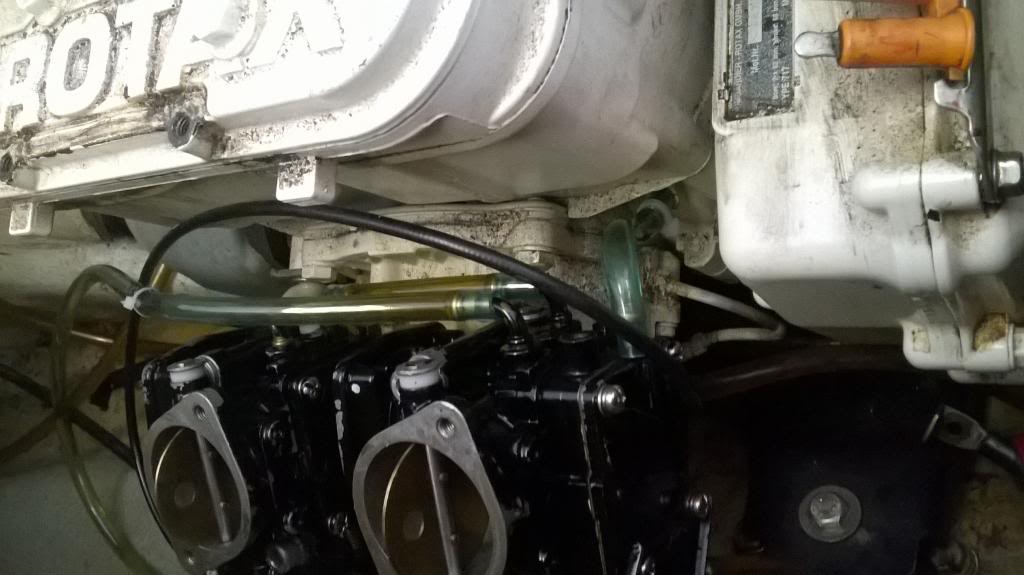

Hope these show what I have going on....I know the tank looks like crap, I'm going to clean all that old glue that expanded all over off and re-do it.
Tough to see in the pics, but does it look like I have the carb lines ran correctly?

I removed everything except the carbs and the main in/out fuel lines. When I crank it, the return line will blow air bubbles, however the pickup line is not sucking any fuel...at all.
So that tells me the pump has to be working right? Seeing as its blowing air out, so maybe I have something routed incorrectly with the carbs?

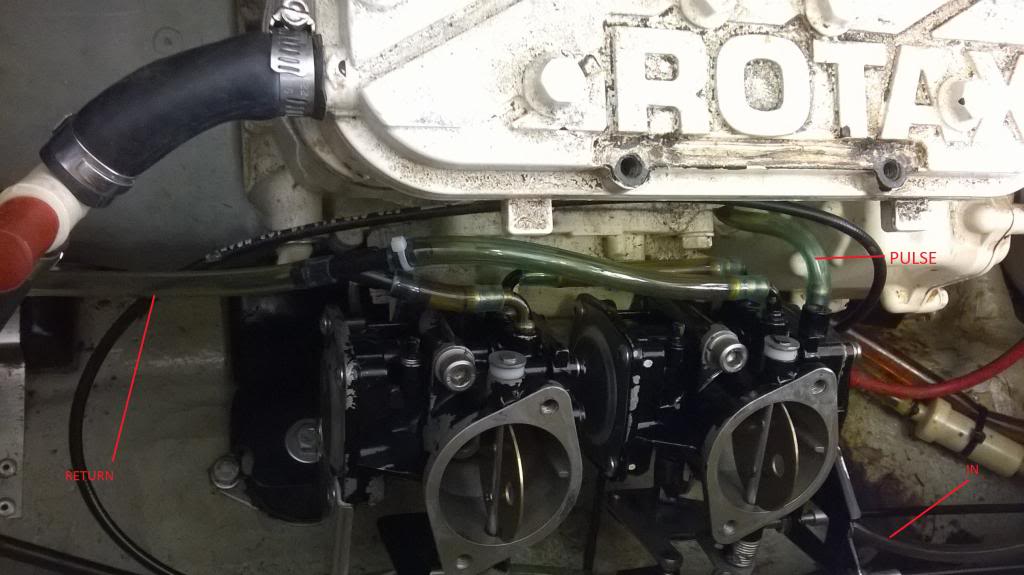

I think your pulse line isn't hooked up correctly. On a 717, it's right below the pulse nipple on the mag carb, looks like yours is going to the other side of the motor. I've got this same ski in my garage right now, just did the carbs, let me grab a photo...
Here you go... same ski as yours.
Adjust your line routing to match these... try the jar test again and report back.
