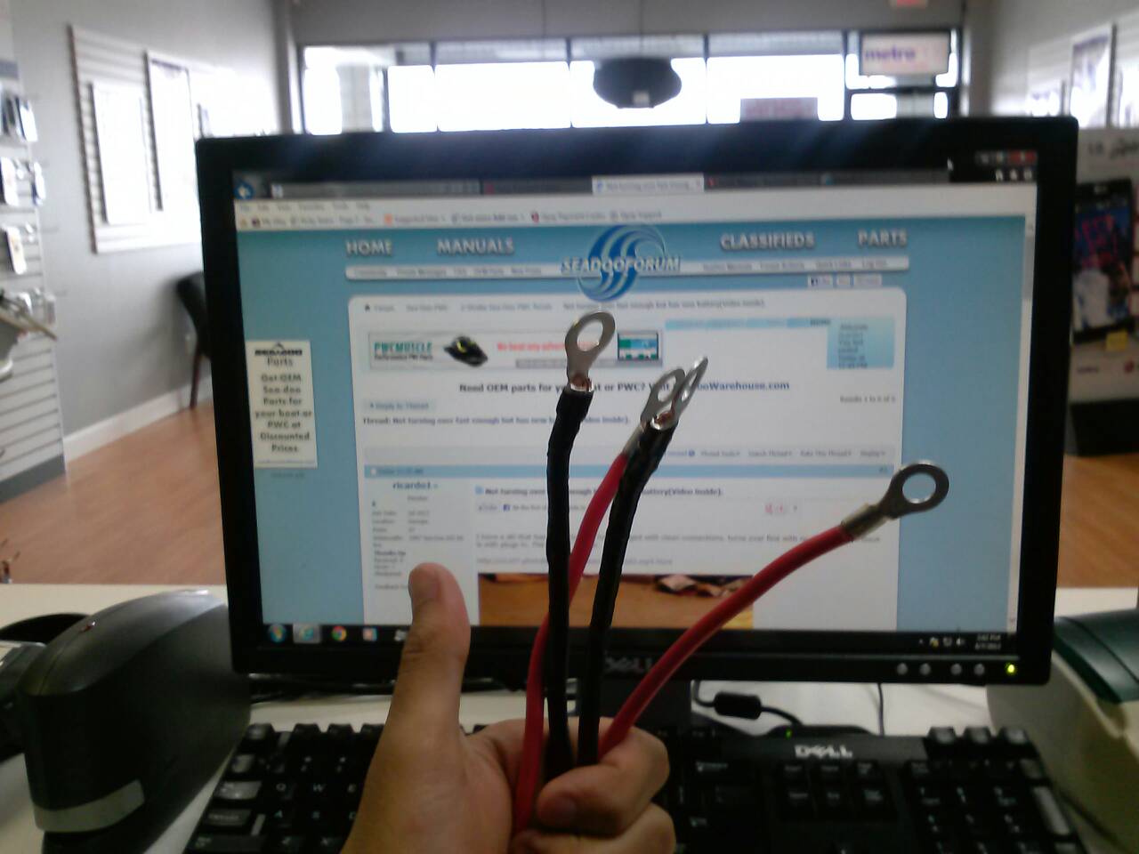

Both cables get hot, but I went to autoze and have 2 new ones that will go on the ski tonight.

Got new cables today to try and see if that's the issue, also have an oem starter on the way.
