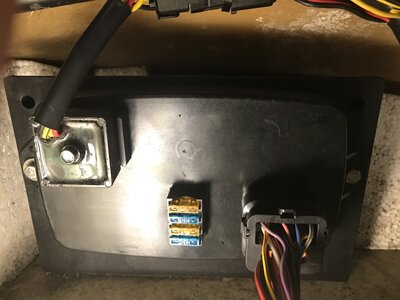

Well I have replaced the starter with an OEM,tested both the dess post and s/s button and both okay,fully charged the battery,cleaned all ground connections and hand turned over the motor with the plugs out and it turns freely and smooth and cleaned all ground connections I could locate and there has been no change. I did jump the 2 solenoid posts and the motor did turn over without the clunking noise? In my previous posts I explained the initial issue which was when I push the s/s button the motor will make a clunking noise and then start to turn over normal but when I release the s/s button it will continue to turn over until I press it a few time s and then eventually stop. While the motor is turning over I have no spark at the plugs? When I connect the battery with dess key off it will spark and after a few times it will not spark and if I wait a moment and try it again it will spark? Today I jumped the 2 posts on solenoid and the motor turned over as should without the clunking but still no spark. Although the MPEM in the ski is the one that was in it when purchased I believe it is an aftermarket and the description online says it is suppose to work with any dess key without programming? This issue has been a nightmare for me and any input I can get will be very appreciated. Thanks
