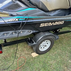

replaced battery went out for a ride killed it to load it up and no power no lights no nothing . Went back home battery is ok took positive cable off for about a hour when I touch the battery it gives a slight spark like something is on but still no power to dash . Checked all fuses they are good . Any help is much appreciated!! 2016 gtx 260 limited

Probably the 30amp main battery relay, hopefully not the ECM
I was hoping so I did the cross jump on the relay post but still nothing at all 🤔. I am assuming I did it correctly I took the relay out and did a jumper wire across the terminal holes and still nothing .
