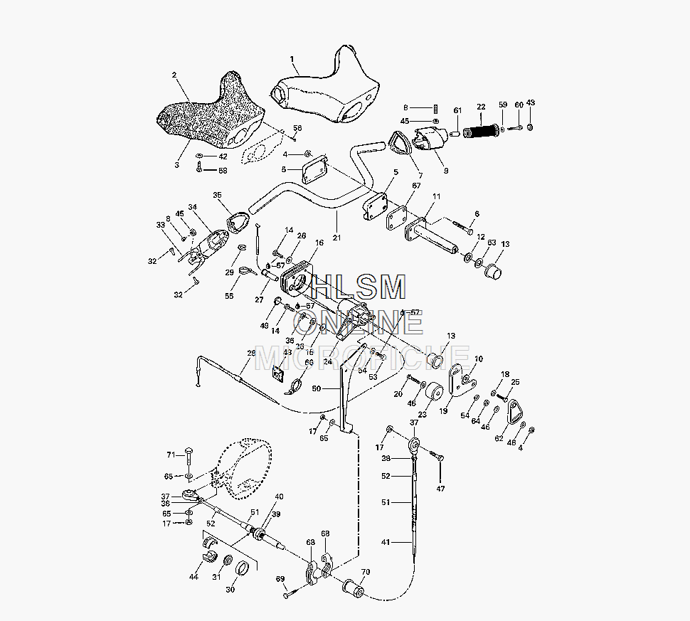

You need to confirm the cable is good visually/mechanically. Then look under the hood and find the cable mounting bracketry should be #50 on the diagram. On there you will find part #70 (on the diagram). That is a slip nut that you can use to center the cable WITHOUT adjusting the heim joints (turnbuckles) on the ends of the cable. #70 is on a plastic clamp. You will need to loosen the 2 M6 screws that hold the 2 halves of the clamp (#68) together.
It'a item #37 of the drawing RacerXX posted. You can see one at both ends of the steering cable inner wire that slides in and out as the handlebar is rotated.
I've seen many times the buckle at the jet pump, which connects the inner wire to the steering nozzle has been misadjusted accidentally by someone while working on the jet pump. This is quite common, also a broken plastic outer sheath fastening nut is fairly common.
The steering cable is item #41, it consists of an stationary outer sheath and an inner wire. The outer sheath is anchored at both ends and does not move as the handlebar is rotated. The inner wire is connected to the handle bar lever at the helm and the pump steering nozzle by a turnbuckle to allow a pivoting action with no binding forces.

If the turnbuckle at the pump steering nozzle is fully threaded onto the inner wire of the cable as it should be, you may make adjustments to the cable sheath at the helm as RacerXX suggested.

The plastic 2 piece clamp was loose. I replaced the 2 nuts with new ones. Seems to have it fixed. Thanks guys
