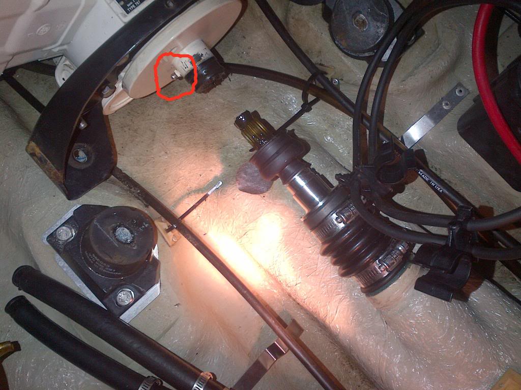

Checked out the VTS. The VTS boot looks good and relatively new, but there was a little moisture/water in the VTS box. Also, the motor wires were disconnected. I then pulled the fuse from the rear electric box and found someone had replaced it with a 10 amp fuse, and it was blown. I put it all back together. Based on the fact the dealer gave me a 60 day warranty I plan to let them troubleshoot it and get it working. I would assume the warranty should cover the VTS.

The fuse is suppose to be a 7.5 fuse. The previous owner probably put a 10 in to see if it would stop blowing it(wrong thing to do with fuses you can go down but never go up). The fuse is blowing because the vts housing probably has a short. I think he disconnected the wires because he may of had problems. My friend picked up a 96 xp for $100. The mpem was blown, we put a good mpem in and the seadoo fired up, the problem was the vts started to smoke. We disconnected the vts right away. If you keep blowing the fuse, replacing the fuse is not going to help, you will either have to replace the whole vts housing or do the vts fix. A bad vts housing can short the mpem, that is what happened to my friends.

And Ill bet you a coors light that dealer gives you a runaround on replacing the VTS. Well that is unless they yank it out of a parts machine.

Called the dealer today to see about the VTS. He said to bring it in and they would fix it. Asked why they didn't fix it before the sale and he said normally they don't bother and leave the trim in a neutral position as the motors are always burning out and most people don't need it. Never had a jet ski before but I know with a boat you use it all the time. How long do the motors typically last and how often does one use it?
They will last forever if the boot gets replaced every couple years. They rot pretty fast then leak water in...then poof goes the module.
