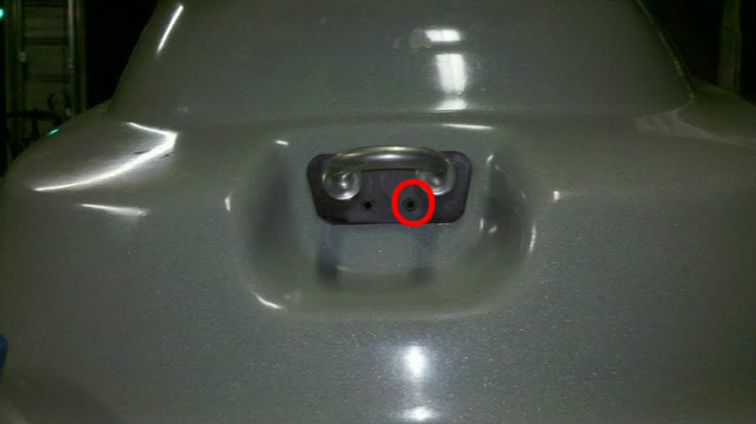

I finally got a chance to get the carbs off and cleaned up. I'm about to order the external rectifier harness and some new gaskets. I noticed today that I had a hose that was unplugged and I'm not sure where it's supposed to go. One end is connected to the right hole on the back of the ski that I have pictured below. can anyone tell me where the other end goes? thanks

The line you asked about probably goes to a pick up somewhere to shoot water out the back to let you know water is circulating.....
That's the pee-hole to see if you have water flowing. The hose should be hooked to the head pipe.

Just wanted to let everyone know that I haven't fixed the ski yet. I ordered the external rectifier that the Doc prescribed. it will be here today and I already have a new gasket kit so I will start putting everything back together this evening. I'm really hoping this fixes it but if not, where do i go from here? stator? Also, I looked up a schematic of the pee hole lines. I found that the white engine used both of the pee holes and the silver uses only one. That explains why I only have one hose hooked up. So, once I get everything reassembled I'll give another update and let you all know where it stands. Thanks for all of your help thus far.

what color is your ski? If you replaced the white motor with the silver one and kept the old exhaust manifold than you may only have one line. I have a 98 GSX Limited that is the Red and Purple model that has the silver engine in it and there are two lines as shown in the lower diagram. The top diagram doesnt match my silver engine the lower one does and it shows the line out of the top of the manifold going to the left hole and the line the goes to the hole on the right is located by the bolt that screws into the exhaust that holds the airbox latch. Standing on the side where the airbox is , look at the exhaust manifold and follow it to the right. You should see a tube going into the exhaust and if its not hooked up you should either see a hole or a nipple where the hose should slip onto. There is a bracket that holds the airbox on mine that has three allen bolts that hold it on two right above the carbs but under the exhaust and one that is a bolt sticking out the right side if the exhaust. I dont have my ski at home so I cant take a pic to show you but that is where that line goes. Where is the line that is at the top of the manifold going?
I have the silver engine but the white manifold, stator cover etc. On my ski, the line that is at the top of the manifold is going to the water valve on the exhaust. I will take pictures of everything tomorrow if i need to.
Circled in red is where that line should go if the top line goes to a pee hole:
Since you said it goes to the water box and you have the old man1312429866ifold that line should be in the same place:
