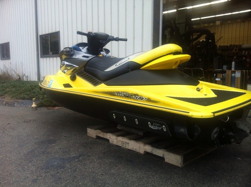

so i took a second look at this seadoo and it was a seadoo from FL and he says hes got the registration and its legit, for the SC washers and head, is this complex and are parts expensive for me to fix?

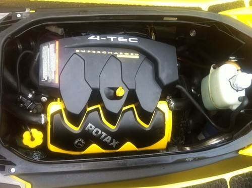

If it has the old supercharger washers and old valves you definately want to change them out. Changing these items requires some special tools and a I would say the degree of difficulty is hard to advanced (for the valves anyways). If you need to borrow some tools let me know, or I can help you out by doing some of the work for you. I would also change the flywheel bolts aswell. The supercharger washers, cylinder head vavles and flywheel bolts can all be done with the engine still in the hull.
