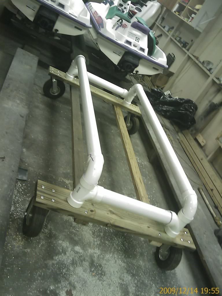

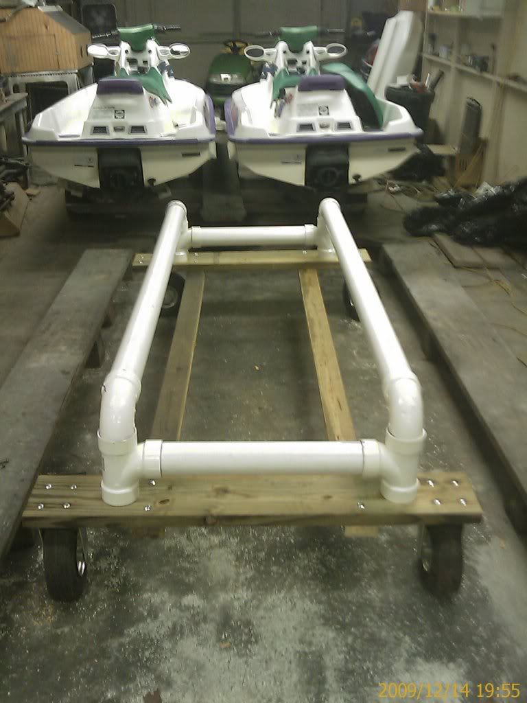

I was looking for a PWC stand and did some research last night.
Since i am a hardcore do it yourselfer, buying one was out of the question.
I was looking at a nice steel one on E-Bay that i figured i could make for a decent price but then came accross a guy that made one out of 3" PVC pipe. At first i thought to myself there is no way i would trust my ski on that however after some thought i realized it would as long as its done right.
So after work today it was off to Lowes for materials (told the wife i needed stuff to hang the christmas lights).
$70 later (for my stuff) and a couple hours i have this:
The wheels i had laying around at work so there was no expense there.
The pictures i found as the design did not use carpet on the rails but i am going to just to be sure.
I made this a little higher that the height the skis sit on the trailer for 2 reasons. I plan on having the skis sit higher on the trailer once i re-do the mounts & i wanted it higher so i am not bending over so much while working on it.
What do you think?
If this works well i am going to make a second one for the other ski so i can get to work on the trailer.
On another note my engine came in today so as soon as i get the ski on the stand i can get to work installing it.
Nice job on the stand.It should work well for working on your seadoo.
Karl

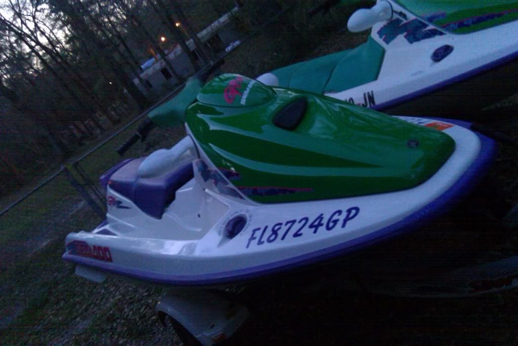

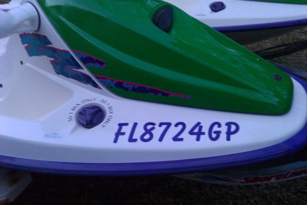

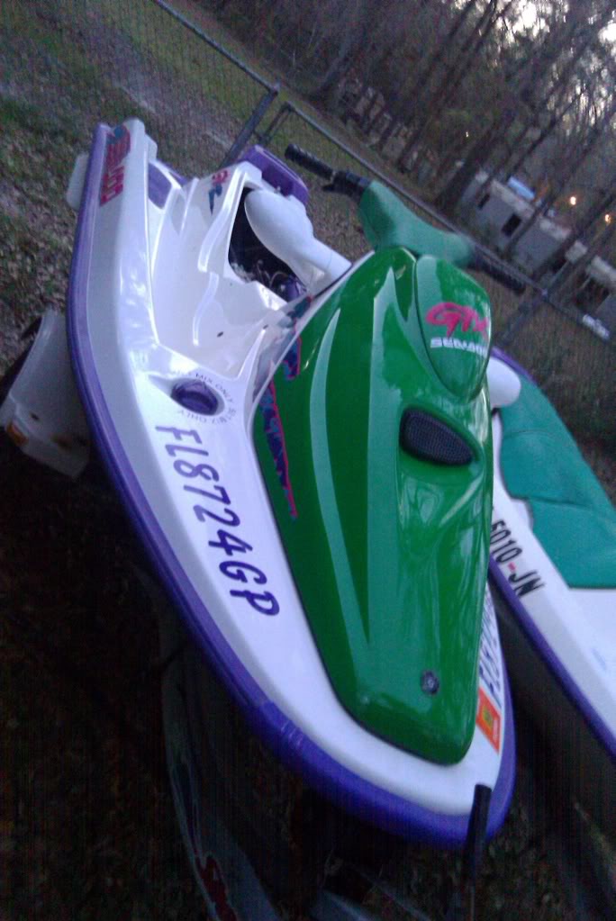

Went and got my new lettering today and while i had the old lettering off i decided to see how they shine up.
Wetsanded with 1200 then used a 3 step cut, polish and wax with my Porter Cable DA Polisher i use on my cars. I am very happy with the way it came out. Went with Purple lettering to match the vinyl i am using on my seats and added the 50:Mix Only lettering around the gas cap.
It was getting pretty dark so the picture is not that great.
Hopefully i can finish the other one tomorrow.

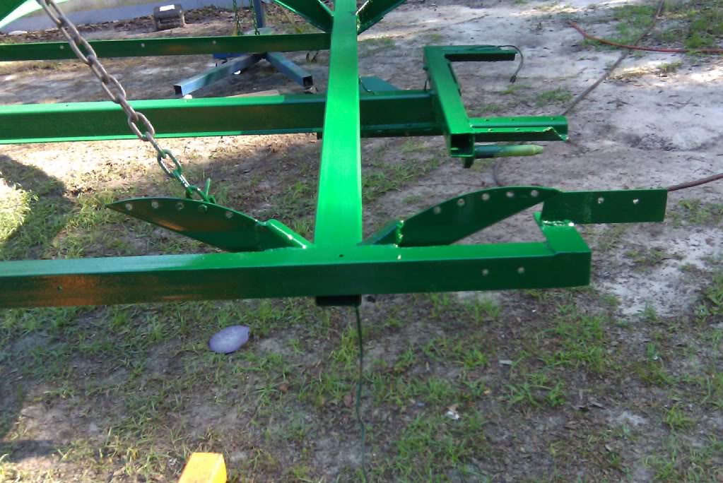

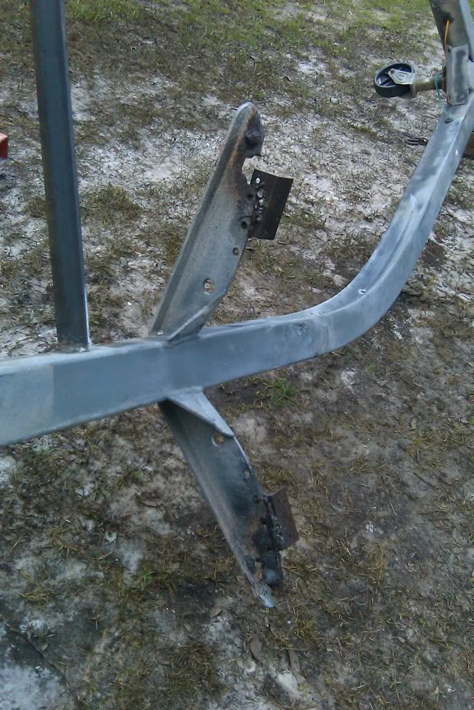

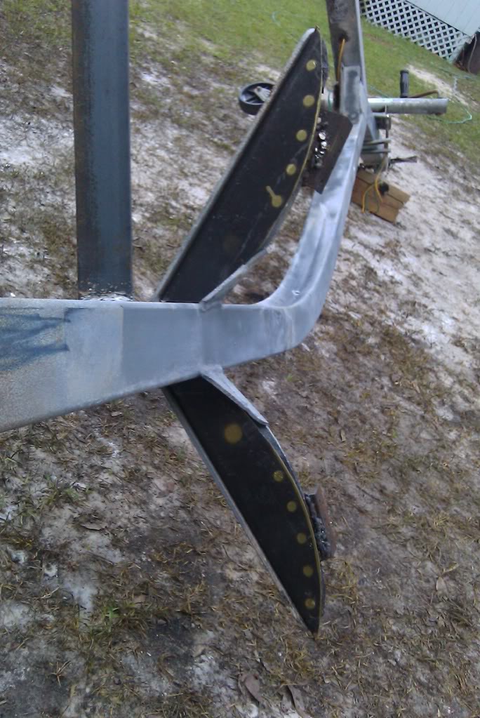

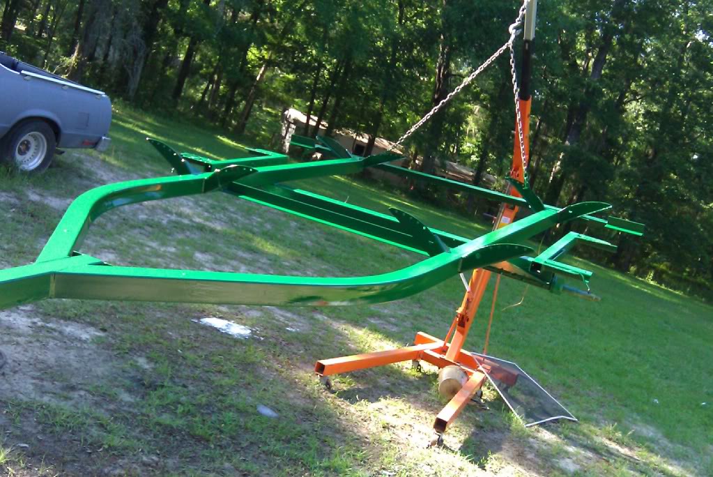

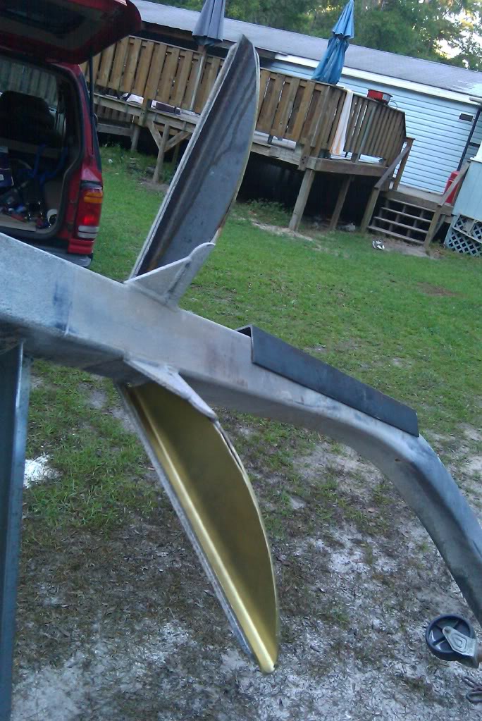

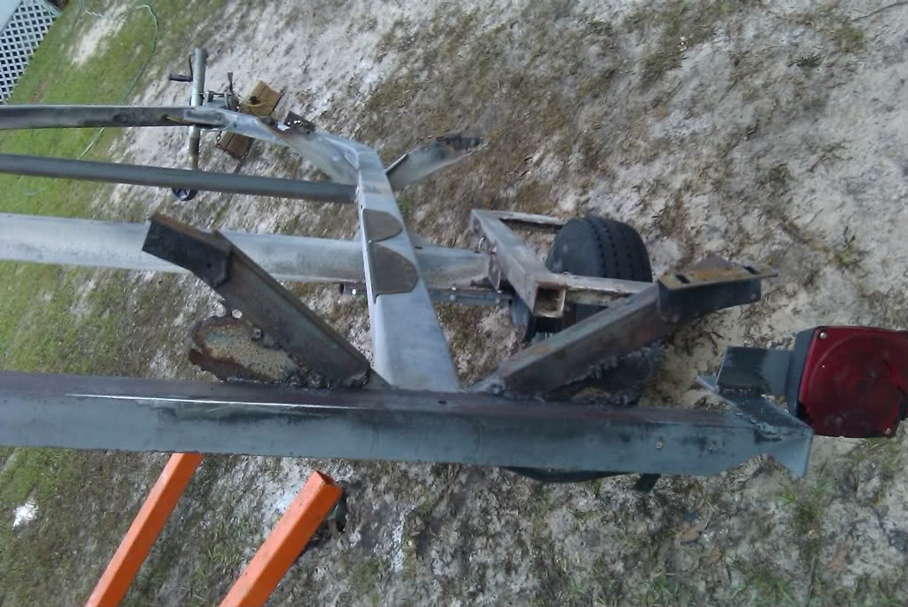

I decided to do some work to my trailer.
Someone in the past fixed some rust issues but i want to do it right.
Started soada blasting it and bead blasting the rusted areas. Going to epoxy prime it and top coat with Green Acrylic Enamael automotive paint.
This is what the one side looks like.

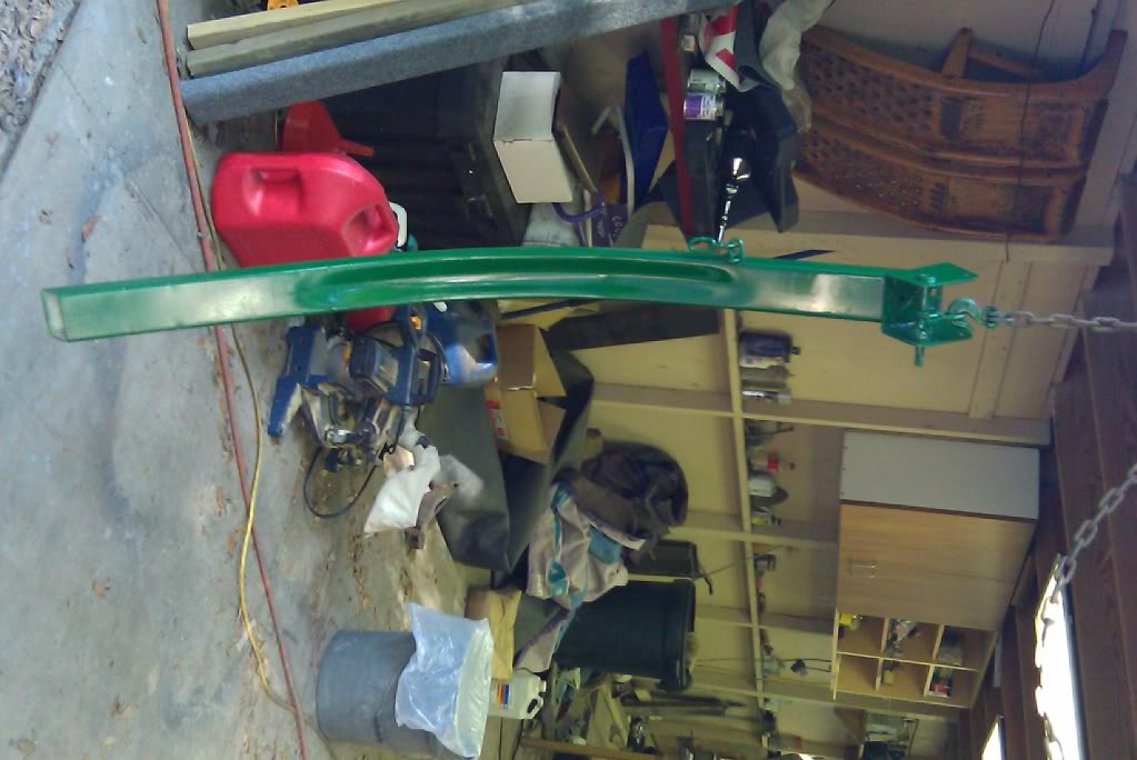

Here are the new plates i made up tonight.
My new plates compared to the orginal ones, not bad since i started with a chunk or 4" tube steel and a sawzall.
Hopefully this weekend i will be able to cut off the old supports and weld in the new ones i made.

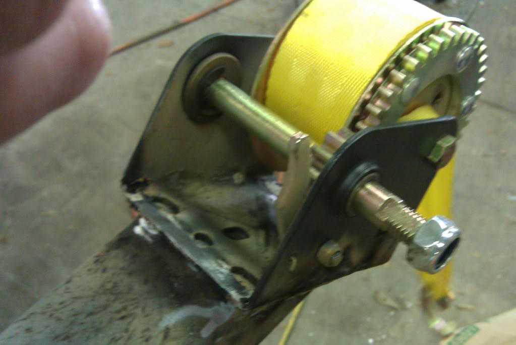

Need to get a new set of winches before i can finish everything.

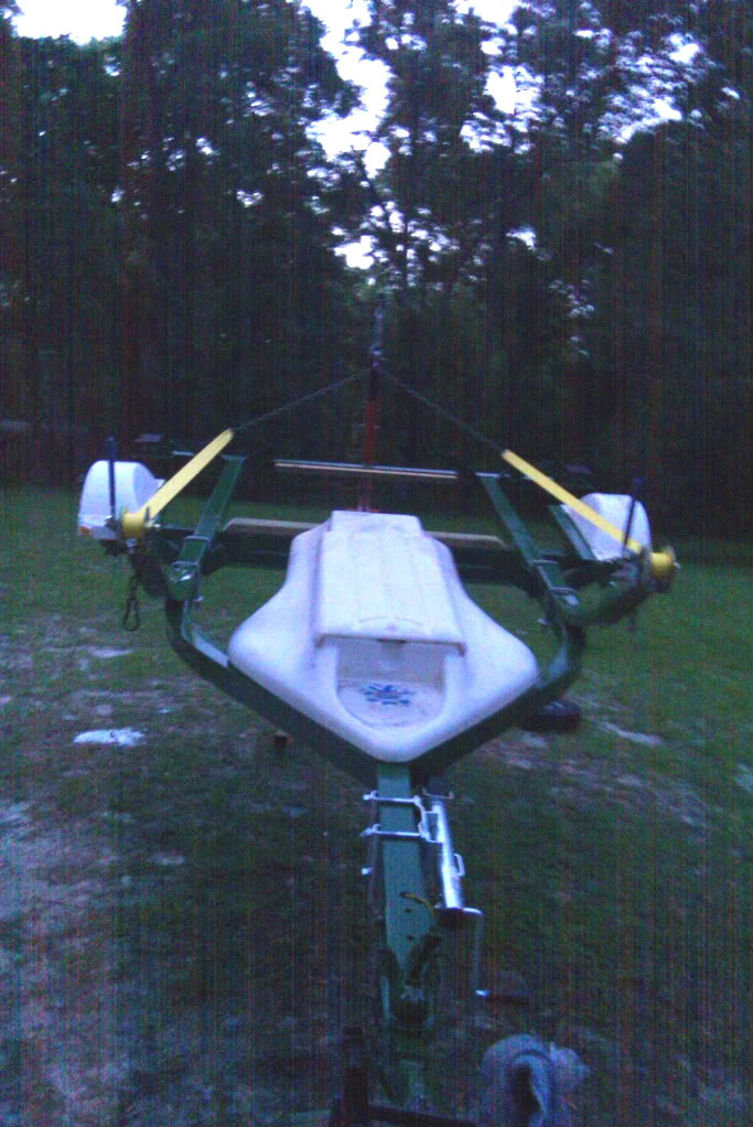

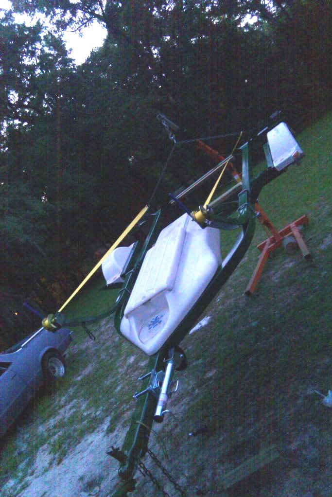

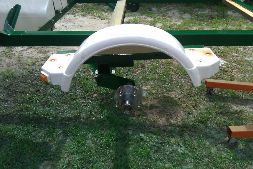

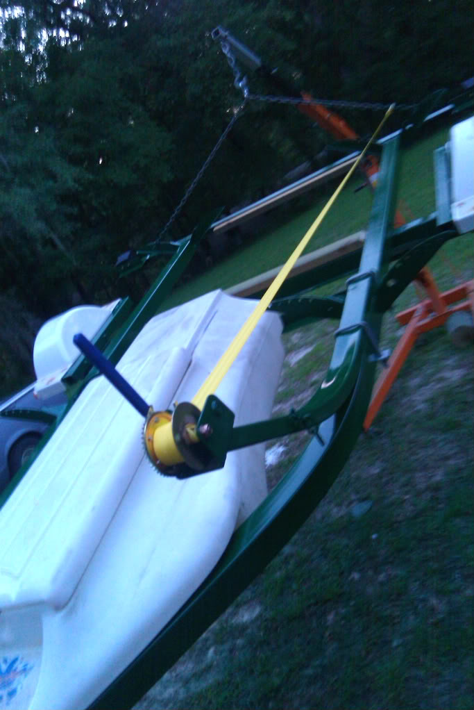

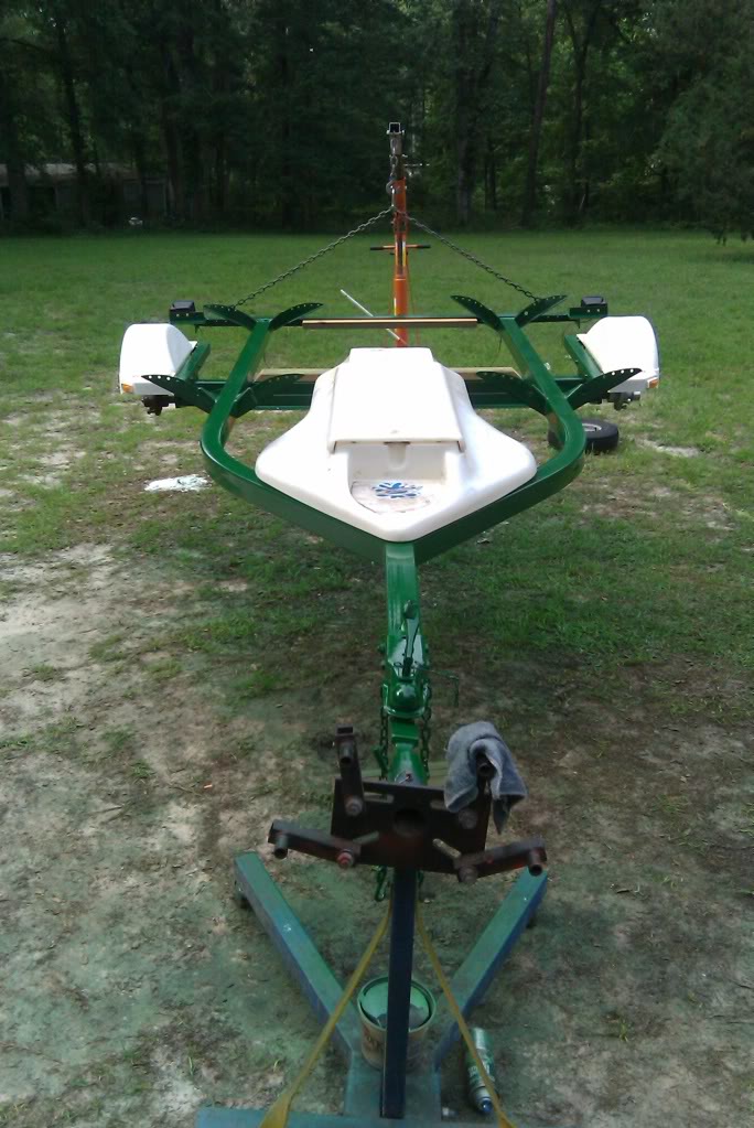

Finally got the trailer repairs done,Replaced the winches and got it painted.
Here is a few pics.
Got a little more done after supper.
Installed the front arms, winches, jack and got the lights wired
Was kinda dark out so the pictures suck but here they are anyway.
