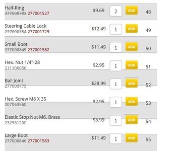

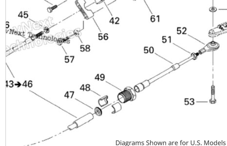

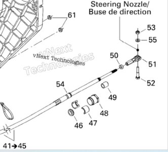

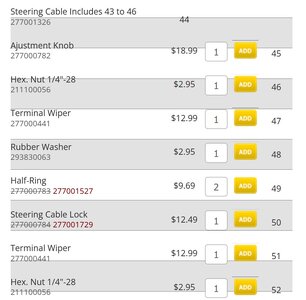

SeaDoo parts lists show two boots HOWEVER for 2005 they list them
as the same. 2005 boots = "terminal wipers' 277 000 441

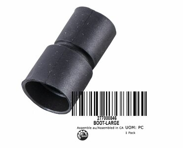

2006 has both boots Large & Small.
Attached; 2005 & 2006 parts lists, & pic of 2006 large boot.
Parts lists numbers vs pics are off as well for both years.
So What I need is for someone with a 2005 to tell me if it
has 2 boots & if they are different please, & if so if large looks like 2006.
