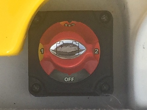

My son and I installed two of these new batteries and this switch today. Had to remove the oil tank to get one in. What a pain! Got one for the stereo and one for starting. Anyone else used these before? Image1459043073.609449.jpgImage1459043084.098429.jpg

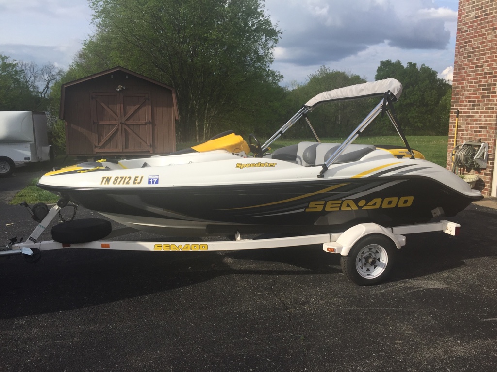

Well... I finally decided on a name for my boat. For years I've worked 60+ hours a week. Recently I have cut back on my hours so I can enjoy myself, my grand kids and relieve some stress. Now when someone asks what I'm doing this weekend I can gladly say...
"Working Overtime"

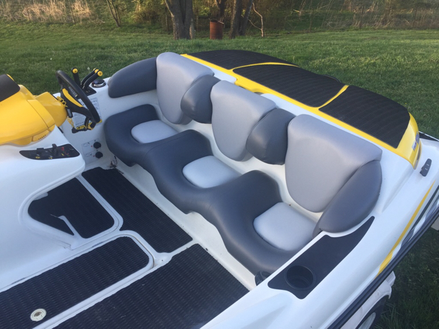

Cnc signman there are tons of different types of krylon paint. Wondering what you used for yours . I see you did multiple coats and than a shiny coat at the end. Any advice would be helpful. My seats are being recovered as we speak with carbon fiber yellow and carbon fiber silver. I am going to repaint my consol hood and all my handles and mooring hooks and have ordered carbon fiber silver 4d sheet to replace the decals on the top of the boat. Here are a couple pics of how the seats are coming.
