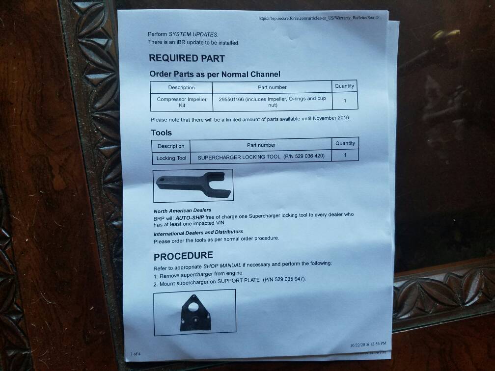

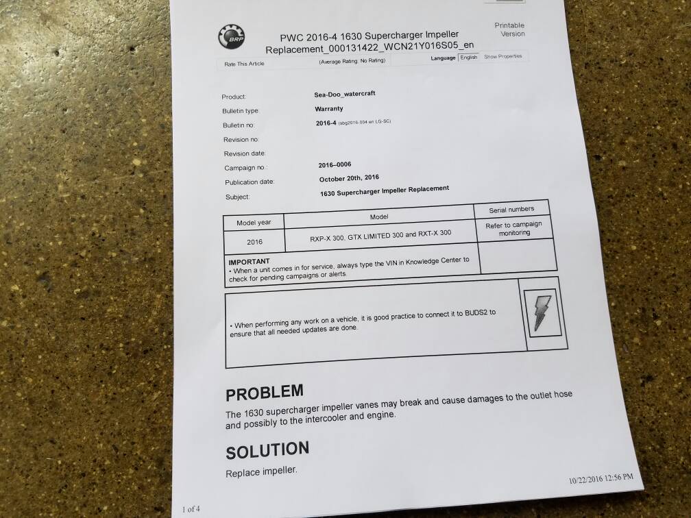

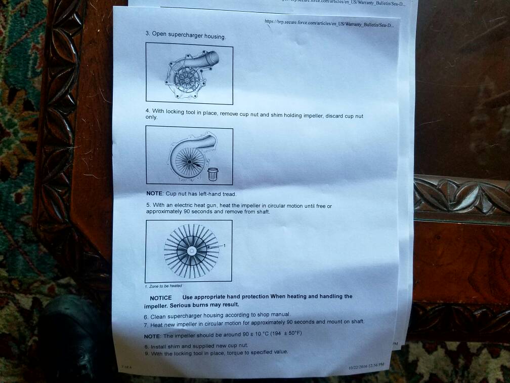

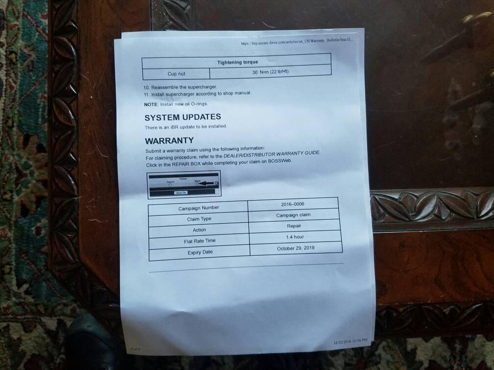

I just heard about this bulletin today dealer said seadoo put it out on the 20th of Oct the supercharger impeller needs to be replaced . I guess they are having problems with them disintegrating and damaging engine I posted a picture of bulletin . All you guys that put tunes in better take em out

I wonder what there replacing it with ? Because there doing the recall on mine I had to leave it

They were too thin too long and too brittle ? I wonder if the 2017s have the new style impeller
