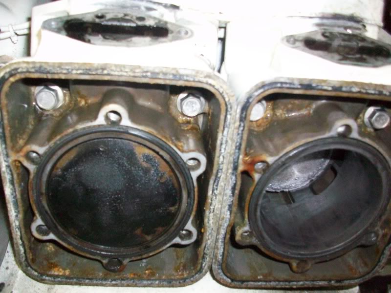

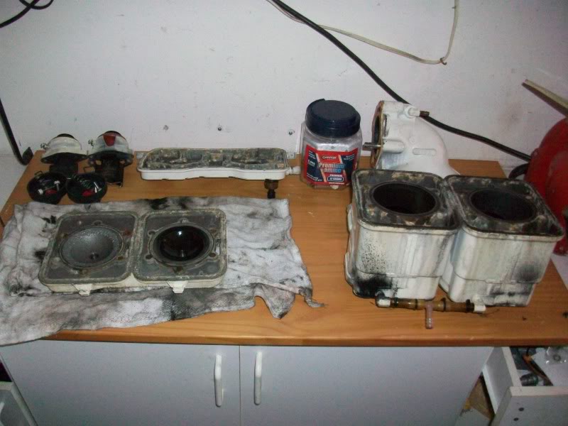

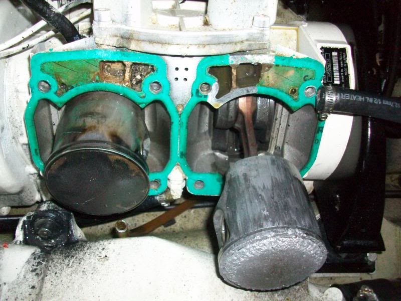

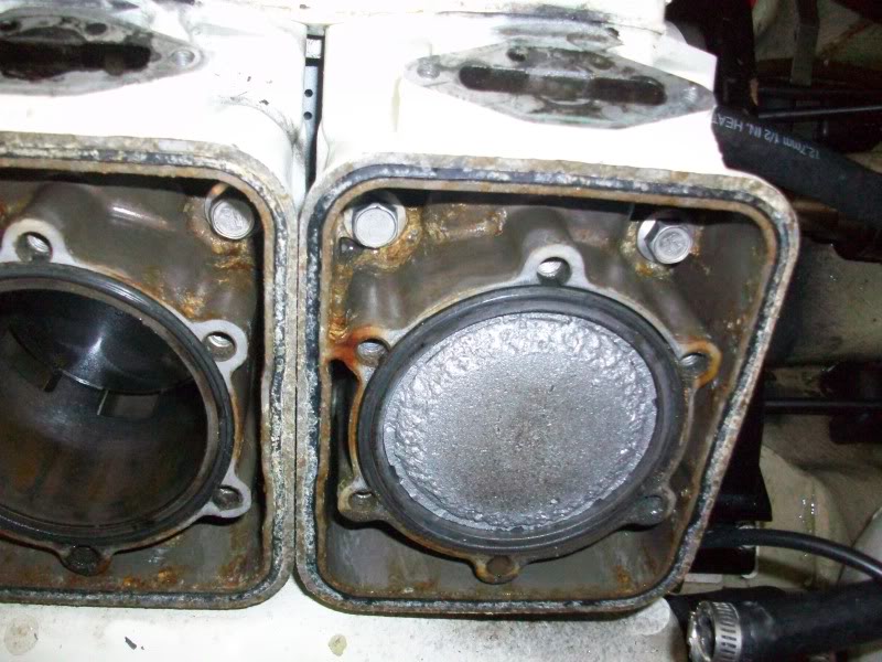

Well I def learned some stuff the hard way doing this LOL. I took the jugs back off after I kept looking at that gasket..that thing got bend and oil all over it and not to mention a ton of blood ( I punctured a vein on my hand and was pouring blood all over there) so anyway, I got another base gasket and put a very small amount of high temp rtv on the back side and kinda glued it in place..after I let it dry for awhile then I started to put the jugs on and didnt have to worry about fighting to keep the gasket out of my way and then getting it on streight.
should I go back and re torque anything after my first ride on it? Not sure if I should pull the head and re- torque the jugs or just ride it and quit worrying :o
Shouldn't need to re-torque... but since the head is sealed with O-rings... it would be a quick job to do it.
BUT... I wouldn't worry about it.
How did you like dealing with those cage less needle bearings or did your Top End Rebuild come with new caged ones? It was a pain in the ass last time when I rebuilt mine using those cage less ones.. But good job and I hope everything works out when you run it.
I went with the ones that are caged. I was in no way gonna mess with the other ones LOL!! Just glad I didnt drop any down in the motor
