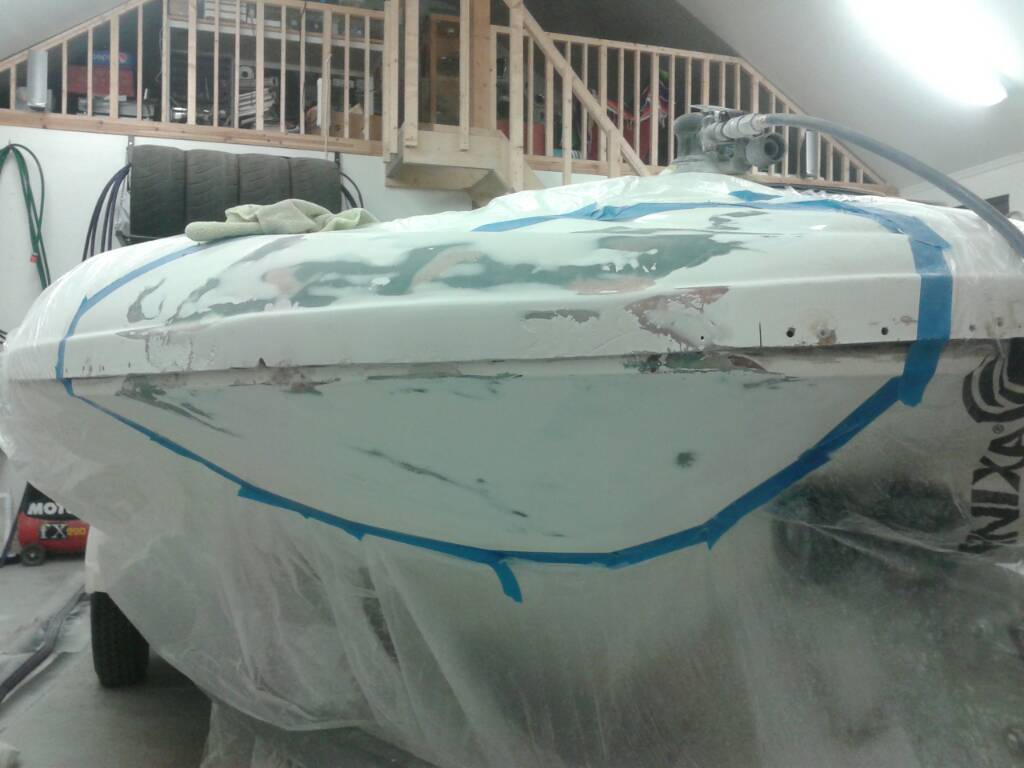

I haven't donne this repair myself,this is just me gelcoating the area.
Previous owner hit a dock a "little" to hard . Damage was almost like fotball size with a tennisball size hole right throug. I've seen pics from the repairjob. Even as this was repaird on a budget it was pretty extensive.
This doesen't help but maybe give a hint on the scale of amount of work thats needed.
