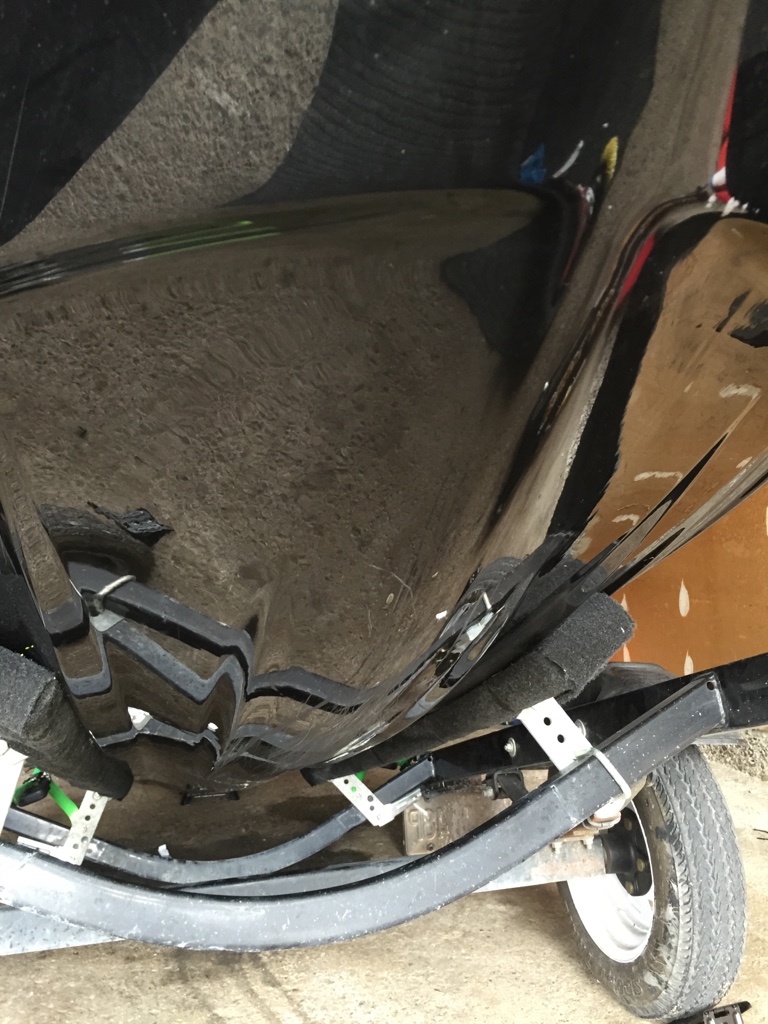

Genius buddy of mine was close to shore and was trying to show off his new moves - drove right on top of a layer of rocks nearly missing the edge of the dock by a few inches.

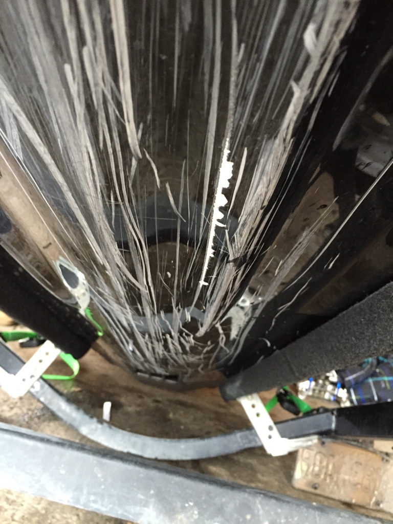

Luckily the damage isn't bad - scuffs that can be polished out, but 2 nice gouges that I need to fill.
I've done some searching, but I'm not sure how far down its gotten. It's white, so I'm assuming I've hit the Fiberglass? Can I epoxy right over it with JB weld?

It looks to me that it's through the gel cote and into the fiberglass, probably needs more than JB Weld, since it's new get a professional to look at it.

There is just to much there for an easy at home fix. I'd take it to an auto shop.

Anyway, JB Weld would make a decent gouge filler, I prefer Marine-Tex myself but either will be fine and I've used both myself. A thin plastic film cut from, say soda bottles for instance, can be used to smooth and level the filler while curing standard sanding smooth then I'd respray a color coat using epoxy appliance paint. Maybe you can get gloss black, I don't know.

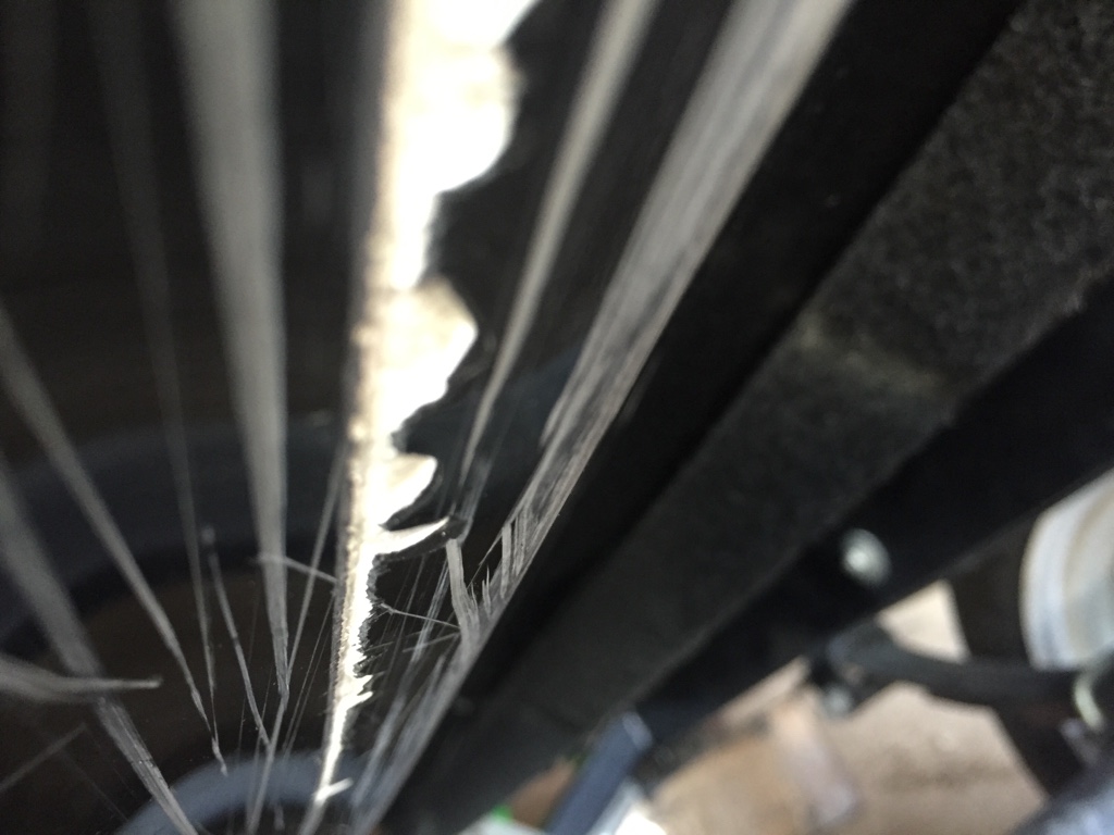

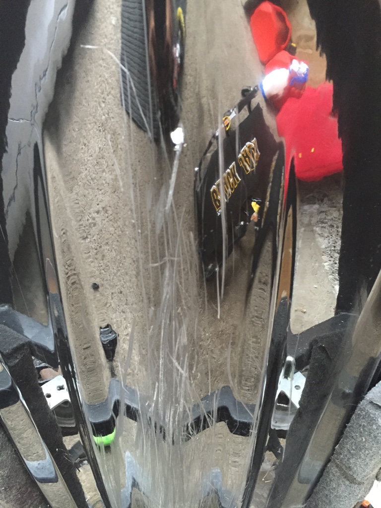

It looks a lot worse than it really is ( I think) - majority of those are scuffs that can be polished right out. I did a quick attempt at compounding and it's already looking better. Gel coat has surface Scuffs.
Should I still bring it in to a shop, or should i JB WELD and wait until the end of the season to have it done ? It's hard to judge from the pics because of the shine, but I believe it's just the gel coat that's all scuffed up.
* Pics after the compounding - will do another compound, polish and wax after.
I think if you intend to have a shop repair the finish, you should not apply any filler that might be incompatible with the system they decide choose to use.
Meanwhile, you may buff or simply leaving it alone will do no harm.

Personally, given the location of the damage....I would'nt be comfortable with a home repair. I've seen way too many pics of ski's suffering de-lamination.

They're built much like a surfboard, where the resined glass cloth is laminated to a foam core thus impact crushes the core and the damage results in delamination.
Brought it in today to a restoration specialist - they quoted me $480 CAD for a complete restore, but he also mentioned that he didn't think it would be an issue if I used JB WELD for the time being. He said to only go through with the restoration if I was sick of looking at the scuffs, otherwise if the epoxy is done right it shouldn't be an issue.
I also beach the ski when launching solo, so the gelcoat it bound to scuff up either way.
Most of you have suggested I have it fixed, but they've convinced me that running it the way it is with the epoxy will be OK.
That being said, If I go ahead and epoxy, what's the best way to sand (what grit) and blend it in? Do I need to paint it or that only for aesthetics purposes (no paint such that if I do the restoration it's easier on them)? The damage is all at the very bottom of the hull so almost unnoticeable unless you get under.
Your second set of pictures look MUCH better,,,
As long as there isn't delamination, which I am not seeing any, then the at home fix will work.

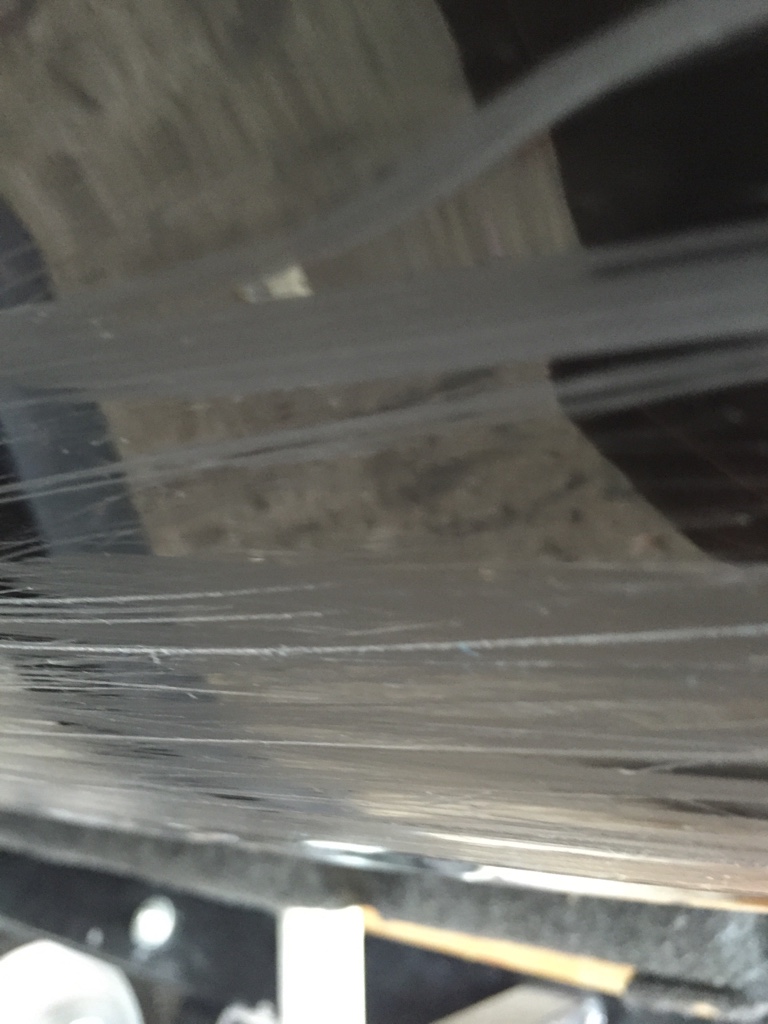

In this photo, what are we looking at? I see at least one layer of resined glass has peeled off but not knowing what that substrate is there could be at least two reasons. Obviously the adhesion was not strong enough to keep the glass layer stabilized, so I'm guessing that's foam core I'm looking at.
Similar to the foam core found in a surfboard.

Looks to me like there is a layer or 2 of fiberglass left.
At speed, all of the water on the bottom of the hull takes a bunch of pressure. Once something like that starts, there is literally no stopping it.
