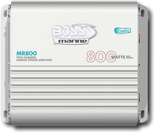

Don't go too big on the Amp,
Eats up batteries like crazy!
I thought a new Marine Optima deep cycle could live, but good times & loud tune can kill any battery!
Make sure you wire the Amp power trigger properly otherwise the amp will be ON all the time consuming power, no volume can still kill a battery overnight...
or take the amp power from the disconnect switch -Off = no power.
