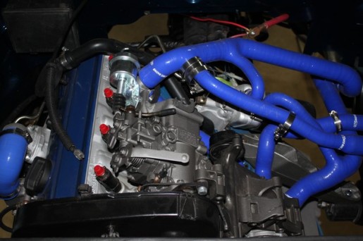

They will be made out of material like this (this is a VW application)
Price is looking to be $149 including shipping in the US for the kit; both hoses and 4 clamps.
What do you guys think? I personally was trying to get to the $120 price point but everything went up. I dont want to go through with this unless I have some serious interest.
If you want to get in on the first run PM me. Thanks!
The picture is just an example...that hose is in a VW application.
