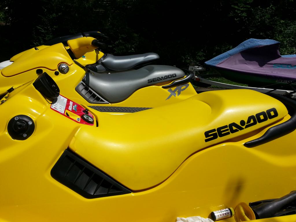

They were 95XP800 Limited and 99SPX only
The Yellow is the 95 and the silver is the 99
I'd give up a good one for $300 shipped. I have two 95's that have nice AP yellow and black covers on them. The original covers underneath may be in great shape but I don't want to harm the AP's to check

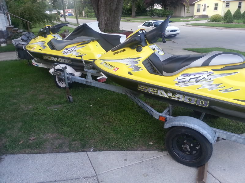

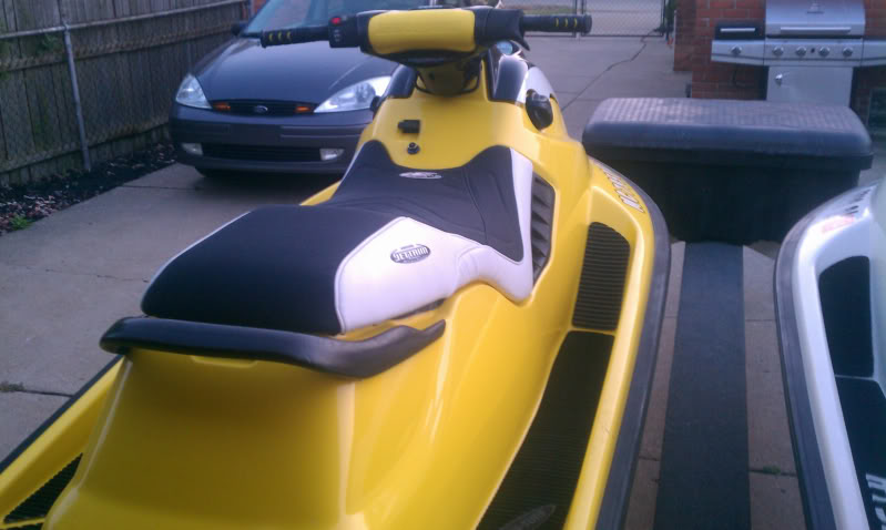

We have been lucky and have snagged a bunch of hump seats
All 3 of the 99 spx's had them
Both of our personal 96xp's have them we bought jettrim seats covers for them.
We got the one with the black and white cover for $50 on craigslist
The silver and black one we bought off minnetonka
We also got one on a 97 spx and we traded a rotary shaft for one.

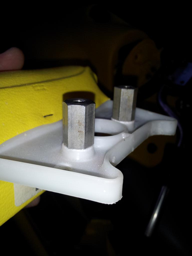

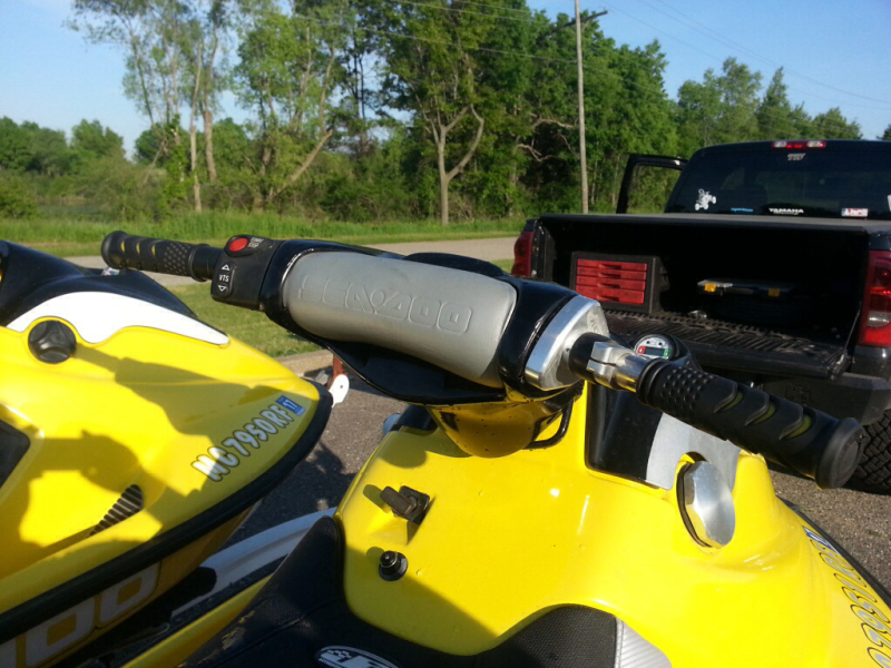

So we just hand cut them and use spacers. Racer uses a different setup. I never posted pictures before. I was keeping this my secret. I think I was the first to post that handle bar pad mod.
The hand cut ones are just aluminum cut to shape and then 6 holes drilled 4 attach to the neck and 2 to mount the handlebar pad. Then spacers are needed for the pad as well
Mine's the same but different. Like you CNC time is difficult to get so I made mine in separate pieces that I could readily acquire at the shop totally avoiding the CNC.
Then I use spacers to drop it down, where you use spacers to move it up.
Hey goodies,
Which handlebar cover is that on the SPX.
Trying to find one like that does not have the cutout holes for the DESS and choke.
I believe they all have the cut out for DESS and choke. The ones on an Rfi only have one hole to fill, DESS only(credit to racer)

He is right, I fill the holes with bondoglass then paint them. I was considering putting the dess post on the handlebar pad, then putting a tach or GPS in the dess spot.
Yup rfi and di do not have a choke hole.
