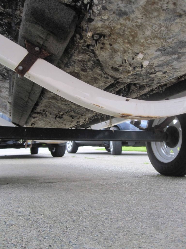

I have a question in terms of what grit sandpaper to start with and move up to.
The pic shows a 2004 GTX 4tec that I acquired that sat in the ocean behind a yacht for 3 months and
the hull was inundated with marine life etc. I was able to scrape off the shells etc but as you can see am
left with the residue of the shells etc.
I need to sand off this residue so I can restore the hull. I cannot scrape off this residue so I will need to
obviously either sand it or use an acid but have declined the acid option.
Can anyone tell me the grit to start with and then move up to?
http://i1067.photobucket.com/albums/u436/lamajama67/IMG_2923a.jpg
Looks pretty rough under there. You are going to want to start with a coarse sandpaper, otherwise you will be sanding forever. I would start around 150 -200 grit and see how well it removes the crud. You can then adjust up or down depending on the results.
Thanks for the reply. I never thought of going that strong. Can the hull withstand that strong a grit usually?
I would not use one until you are ready to finish (high grit paper). Too easy to accidentally sand down to the fiberglass with a powered sander unless you are very adept with one.
EDIT: To answer more directly...Yes it is OK to use one, but the above statement applies.
