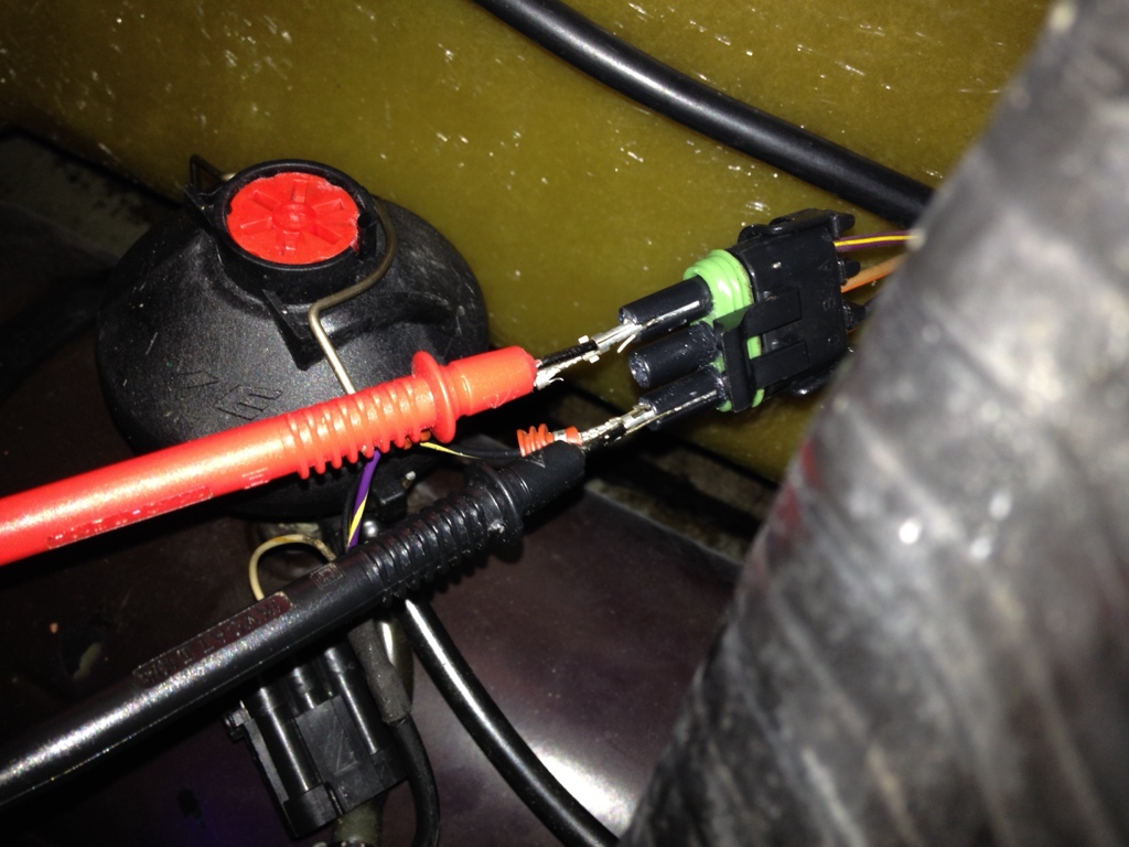

Thanks. The star turns well. I think I figured out the service manual directions. I pulled the pins out of the sensor side connector and plugged them in directly to the other side if the connector. This lets you connect the volt meter. Mine tested at 8.67 volts static and varied down to 8.2 volts when I spin the star. So I guess that passes the test. I will check up stream for loose connections. Here is a pix of the test.

You can dissassemble the connector and reconnect the pins together or you can simply back probe the connector using straight pins, such as a hat pin (I do it this way).
