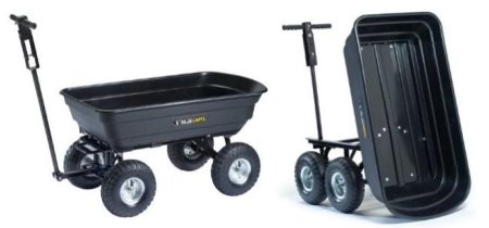

I've been using this dump cart thing to haul the EZ up, grill, kids toys, spare life jackets, Ect back and forth from the truck to the beach. We spend the day out there so it's a significant amount of stuff to haul.

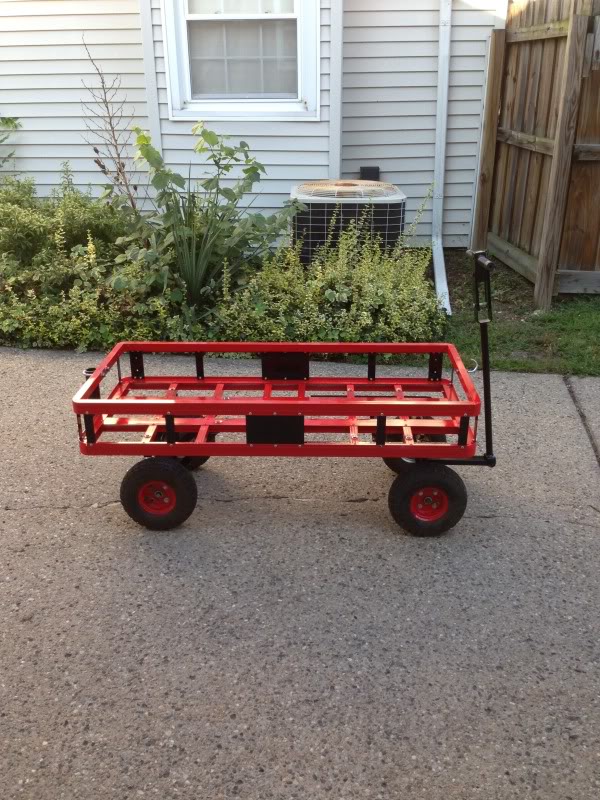

The old way...since I already had this cart and I didn't want to buy an expensive wagon.

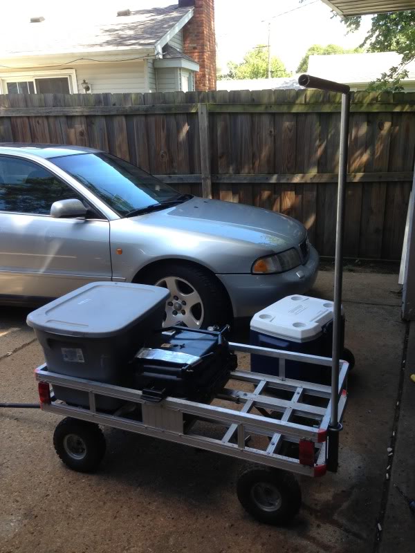

It worked, not a whole lot of room, but enough to keep me from being completely overloaded. I didn't want to spend a whole lot of money, and I got to thinking about stuff I had in the garage. Had an aluminum hitch basket that doesn't get used since I have a truck and a trailer. So, it's been sitting in the garage for 10 years.
Combine the two and now we have this.

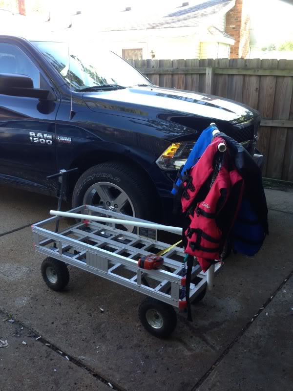

The bar on the back will be a T to hold life vests and keep them off the ground. Should get us through a few more summers.
Next project is going to be powering drive wheels. Might as well make it self propelled while I'm playing in the garage
