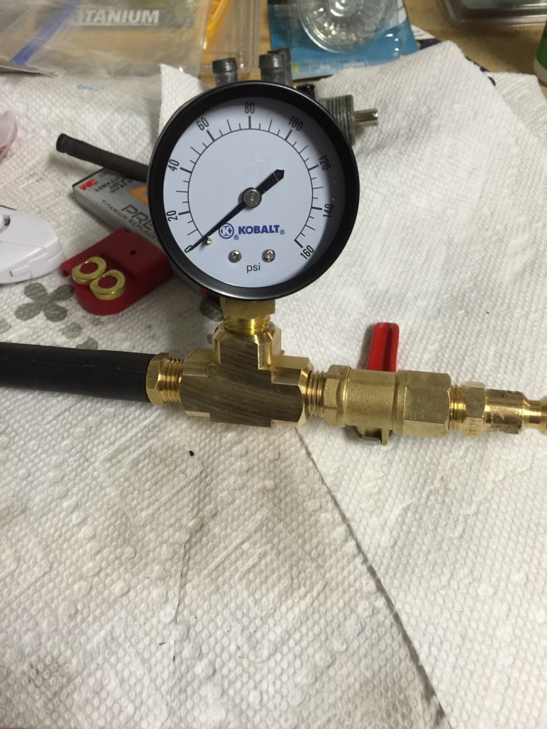

Ok, will be checking leak down test on carbs tomorrow just got back from lowes and made me a pop-off/leak down tester. I'll check the manual for checking RV clearance. Is it pretty simple?

Ok, I finished carb leak down test by using hose pincher on the return line and connecting pressure tester to fuel inlet on the MAG carb. It held 15psi for 10 minutes and indefinitely. I guess the next step is to check the RV cover clearance. But before I do, wouldn't that cause hard starting period and not just hot restarts. Again, my issue isn't really a hard start or restart. It starts instantly and runs properly. The only issue is keeping it running if you cut it off And let it sit for 15 minutes to an hour. Then it cranks immediately and will only idle for a second or two unless I quickly pull and release the choke. If I do this a few times to keep it running it will then idle on its own but will not come off of idle without dying unless I do the same thing with the choke again.
